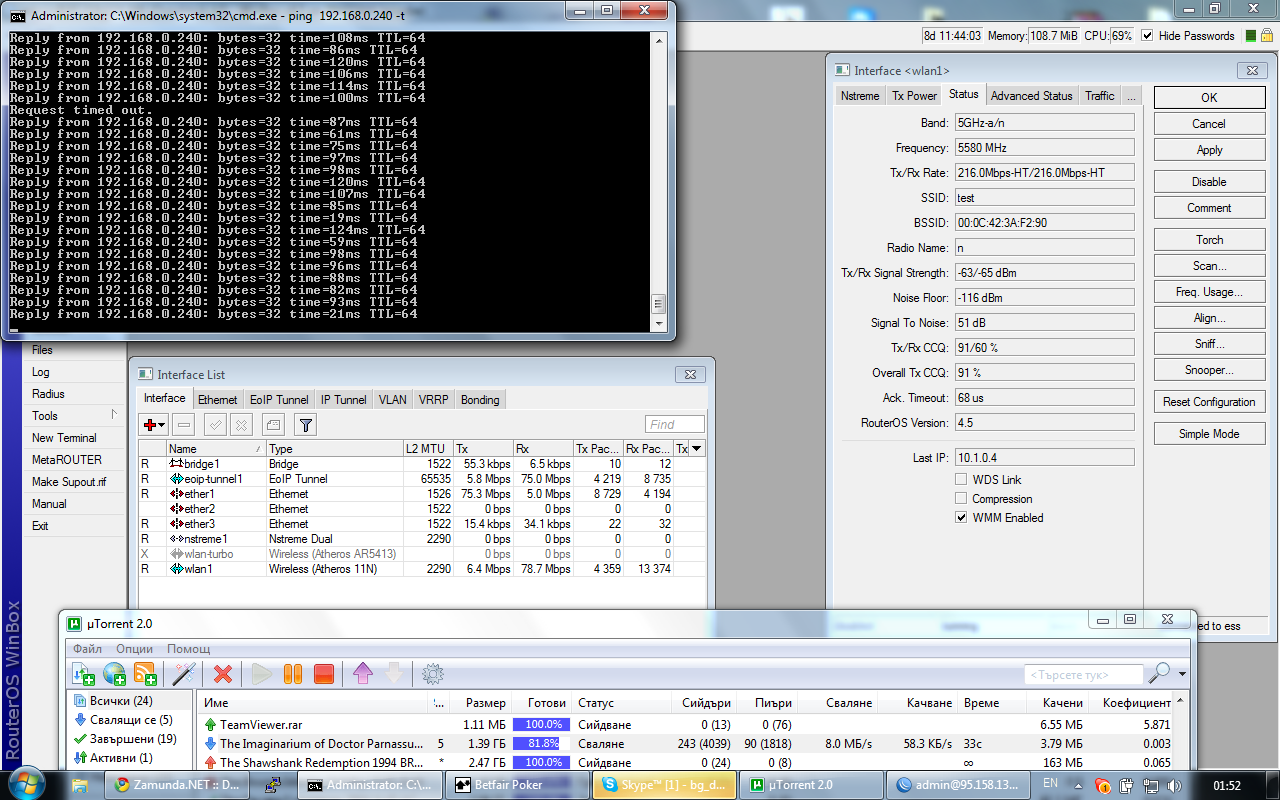

Well…here is picture of 5km backhaul link with 2 60cm solid dish antennas and R52N cards on RB433AH
I reached better speed with 90cm dish :slight_smile:
What are ping times like when the pipe is half full? With those ping times and drops, there is no way I could call that a usable backhaul.
To be honest unless you have some traffic shaping setup your gonna have those results when downloading with bittorent. I think if thats a single chain link that speed is pretty good. The same thing would happen with a ethernet cable if your maxing it out. Your just flooding it with the torrents. Use pcq queues on the links and set the max rate a little below your best throughput. 11n isn’t some magic switch that means you don’t need to understand routing? Also when I tested using ip tunnels I did have quite bad results. WDS seems to be OK although some people here say tunnels are faster I have not found that so far but only tried EOIP.
