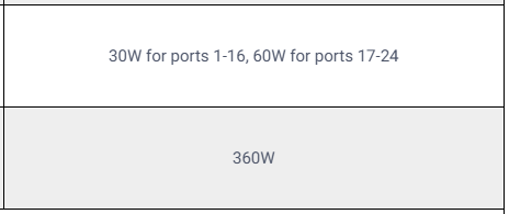

Better support than no-name. But look at PoE specs.
Also, only 8 2.5G capable ports + 16 1G which may be sufficient for your needs.
Above are from https://documentation.grandstream.com/knowledge-base/gwn78xx-user-manual/
But make sure you look at specs closely before purchase so you don't have buyer's remorse; no matter what you are buying, always read the fine print (i.e. Due diligence)

I think this should be sufficient for my needs. I only have a couple clients that are 2.5GbE and I also need that for WiFi7 APs. I’ll have to watch the PoE budget for some IP cameras, but this one checks all the boxes I need for now.
