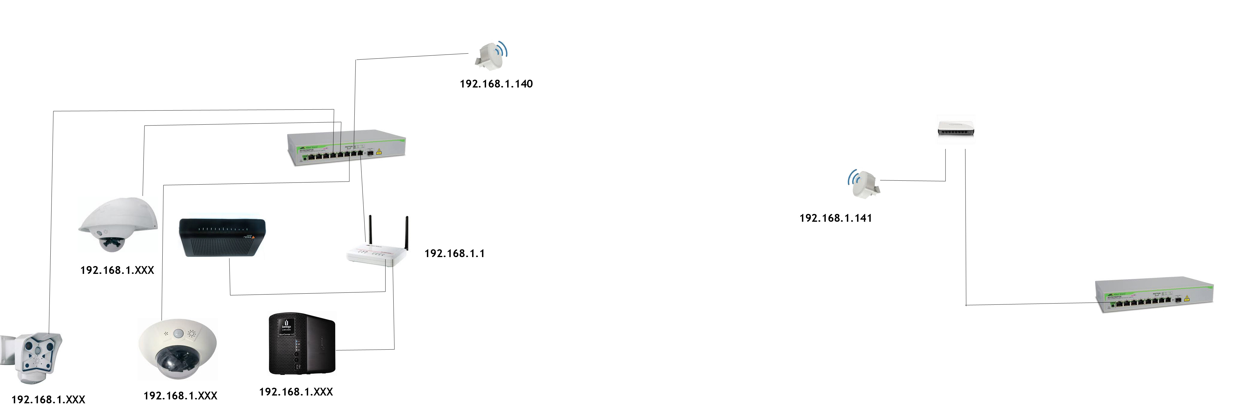

trying to make an connection over 400/700 mtr.
on side 1 i have a internet connection a router and the mikrotik.
on side 2 is where the internet most go to.
i did follow this help guide https://www.google.nl/url?sa=t&rct=j&q=&esrc=s&source=web&cd=2&cad=rja&ved=0CD8QFjAB&url=http%3A%2F%2Fwww.ispsupplies.com%2Fcontent%2Fresources%2FQuick%2520MikroTik%2520SXT%2520Bridge.pdf&ei=PKilUpuyGLCT0QWVkoHADw&usg=AFQjCNFybZrZ5Qigq9HlfRwmBb-RM_Zozg&sig2=fGomOO37weQCS9KH9lOg4A&bvm=bv.57752919,d.d2k but didn’t seem to work at all !!
I already got the link between the two sxt 2’s but no internet att all !!
now i hope that you guys can explain how it most be done !!
sorry for my english ! i am from the netherlands
kind regards Martin Weijers
this is the setup
