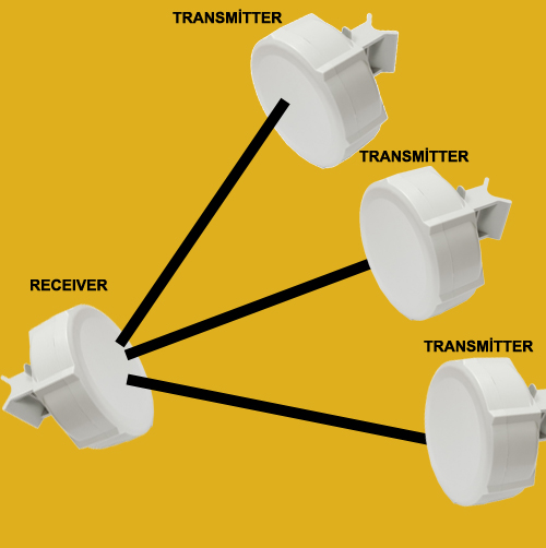

hello everyones
Mikrotik with SXT 5HnD
Can you give an example configuration for an application such as in the picture
thanks
hello everyones
thanks
well, if you upgraded one RB/SXT to a Level 4 License, then this is technically possible.
However, the SXT has only a 25 Degree Beamwidth, so if all your clients lie within that window, than it should technically work! If you are interested to know your performance envelope over the wireless link, Mikrotik has now published some test speeds on the link below -listed at the bottom of the page:
http://routerboard.com/product/108
-Brad
