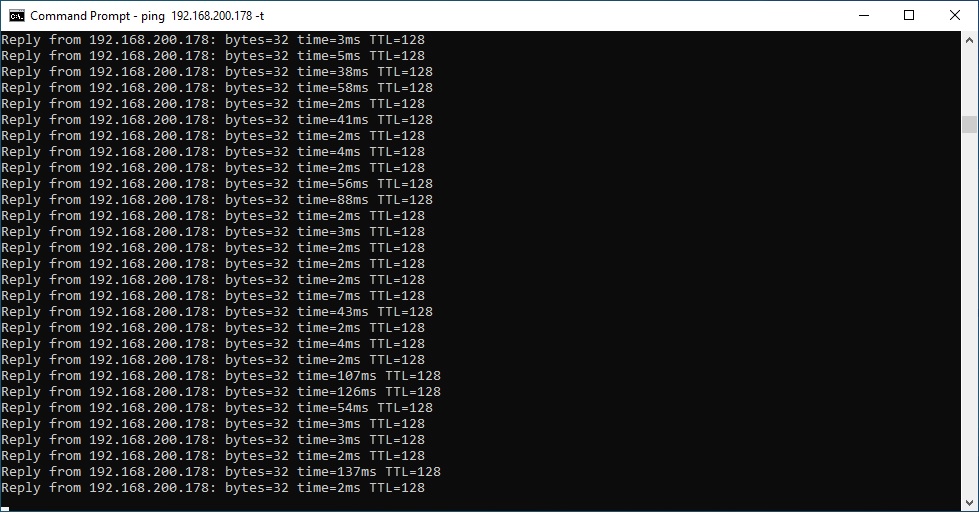

I have connected two mikrotik sxt sa5 ac but the connection is not so good, I have fluctuating wireless connection between the two equipment. How can I improve it?

Difficult to help if you only give RTD (ping) values.

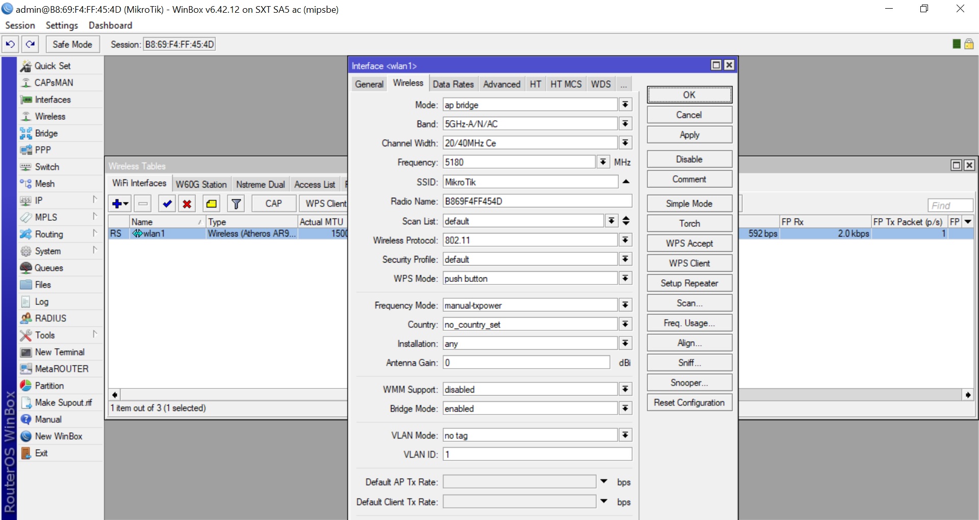

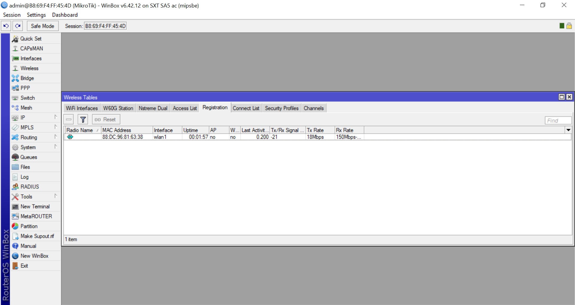

What is your setup? Distance covered?. Free line of sight ? What are the values in “wireless registration”? What did the freq usage tell you ? Don’t use “auto” for any setting, but check the environment and take control, members of the forum can help in this.

Your signal strength is way too high, saturating the receiver. Put both devices at least 2 meter apart.
Set country and set antenna gain to 14 to be in the legal limits. Then further reduce the signal strength ( setting higher antenna gain value) to have a received signal of around -40 dBm even -50 dBm (you are at -21 dBm, a receiver saturates around -30 dBm.) Otherwise you are yelling with a megaphone is someones ear, and they will not understand what you are saying. Even the reflections on the wall are enough to totally disturb the transmission.
