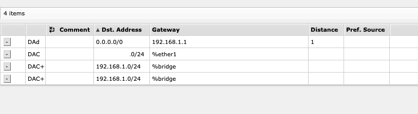

If you go to terminal, what does /ip route print show ?
OK… DHCP removed from bridge.
[admin@MikroTik] > /ip route print
Flags: D - DYNAMIC; A - ACTIVE; c - CONNECT, d - DHCP; + - ECMP
Columns: DST-ADDRESS, GATEWAY, DISTANCE
     DST-ADDRESS      GATEWAY      DISTANCE
DAd  0.0.0.0/0        192.168.1.1         1
DAc  100.81.243.0/24  ether1              0
DAc+ 192.168.1.0/24   bridge              0
Looks like you got a default route to Draytek there.
If you now use on terminal a ping to whatever site, does it work or not ?
Removed 192.168.1.3 IP
DAc 192.168.1.0/24   bridge              0
Found problem… DNS :slight_smile: IP ping - OK, domain - not. :slight_smile: how to fix?

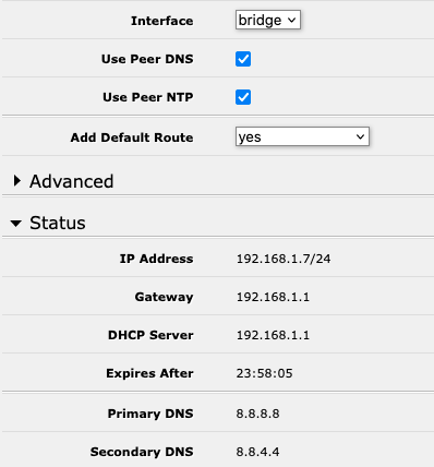

DHCP client config
Internet not working.
