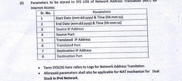

Your 100 % Correct, but they don't listen our version. they need only the below format .
Is clear who write the guide do not know anyting about how the things works,
the line “mm:dd:yyyy” confirm that.
Your example also differ on what requested, where is [ASSURED] and “delta-time”?
Following the guide the log must be like:
Jul:01:202113:43:22,Jul:01:202113:43:23,1.2.3.4,5678,11.22.33.44,5678,159.148.147.239,443
They may want it as much as they like: it can’t be done properly.
  1. TCP connections may be closed by the client, the server or by timeout. Some bad written software don’t close the connection at the end - it just expires. The best that could be done would be to log the timeout - but it wouldn’t tell them the duration of the event.
  2. UDP connections doesn’t exist: UDP doesn’t do connections. Sure, the software using UDP may implement the connection layer - quite common with VPNs - but to the firewall/router… nope.
They are thinking about traditional telephony, where a point to point connection is made before the telephone rings. Network doesn’t work this way. What they want doesn’t make sense.
again: who write the guide do not know anyting about how the things works
Simple solution, stop doing NAT and provide qualty service to your client assing one Public IP for eachone.
The log is simply: each client has his own IP.

if i get the log below format it will be fine
The delta time is negligible , those logs are taken from different server not in mikroitk.

This is the requred format from “Telecom” Office:
I do not see any key=value
