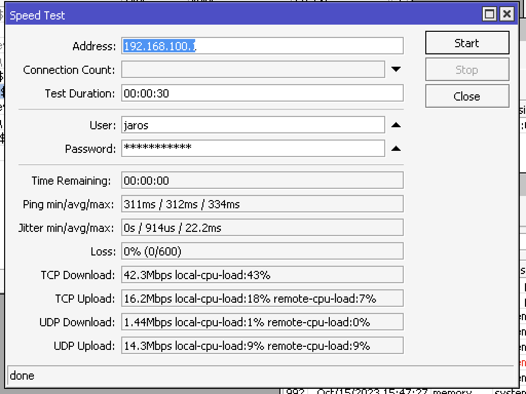

so now:
“server” public IP, port 13231 open, peer created, UPDATED: now I have handshakebut it just doesn’t handshake. configured as roadwarrior from this post:
https://help.mikrotik.com/docs/display/ROS/WireGuard
wanted result:
I would kindly ask for help to: have active and working WG VPN with all marked as CZ_VPN packets goes through it, and also for all static DNS request defined below.

thank you very much, I wish so I could crack it by myself, as I did with the packets marking, sending through pptp vpn only what needed. but This costed me 3 days and 3 nighters and still no results…
UPDATE: I managed to have a handshake, and ping through the tunnel, and it looks like some the data goes through it as well, there was GW for default internet missing, added to config above
now I need to send the static DNS and question is, can I make it faster? the pptp looks much faster than wireguard at this stage. I guess somewhere might be an user error in filtering or data going through
thank you very much to everyone for help…

yes I have one mikrotik in AU and second in the CZ.
meanwhile, I managed to get the traffic going. I accidentally deleted default GW for the internet :laughing: and also was able to compare the tunnel capabilities (I have 50Mbps connection)
PPTP:
wireguard:
I succesffuly marking the data with the same mangle I did with pptp.
one service, which is immune to dns leaks works perfectly.
the other one which is sensitive to DNS doesn’t work at all.
so I am using this static DNS forward (worked on PPTP)
