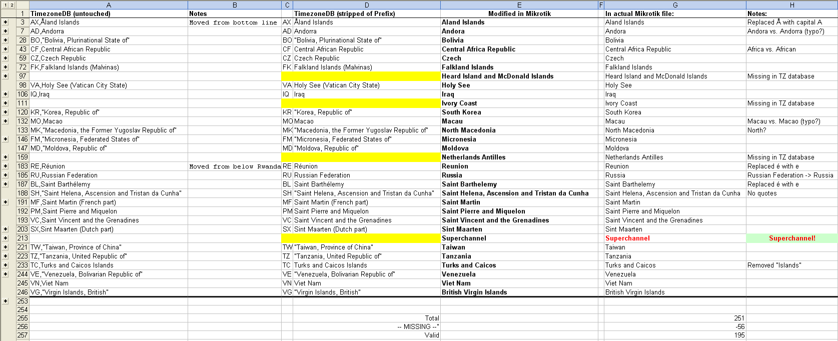

For a small (side-side) project I am working on, I need to simulate in a drop down list (in an Excel worksheet) the same options available in ROS about countries (and while I am at it timezones too).
I wasn't able to find a suitable way to extract from a running ROS (in CHR) these two lists, so I went through the ROS files and attempted extracting strings.

Since I don't trust anyone, particularly on the internet, I actually checked both against the actual timezone database here:
https://www.iana.org/time-zones
And found some minor differences (mostly typos) between the extracted strings and the list published on driverscat.eu.
BUT I found several differences between the actual TZ database and the strings extracted, a lot of countries are simply missing in Mikrotik AND there are quite a few typos/differences, some are understandable, like Åland Islands becoming Aland Islands and a couple é's changed into e's, but Andorra becoming Andora and Macao becoming Macau?

Anyway, attached the comparison worksheet.
countries.zip (59.6 KB)
EDIT: updated with an added comparison against ISO 3166-1

Here is a screenshot of only the differences (and BTW 56 entries are seemingly missing):
So, the correct statement should be something more like:
We made our own list of countries, inspired by the TZ database, choosing which countries to include and writing them as we fancy.

Just compared TZ database country against ISO 3166-1.
They are very similar (though not exactly the same), but also ISO 3166-1 cannot be the Mikrotik source (without changes).
There is a long time debate whether Turkey should be called Turkey (as in TZ database) or Türkiye (as in the ISO 3166-1) but the Mikrotik using Turkey is fine.
BUT IF BOTH TZ database and ISO 3166-1 call Côte d'Ivoire "Côte d'Ivoire" Mikrotik country "Ivory Coast" appears arbitrary (though still correct).
In any case, these remain typos in Mikrotik:
Andora->Andorra
Central Africa Republic->Central African Republic
Macau->Macao
And the country:
Heard Island and McDonald Islands
is seemingly only present in Mikrotik's list, even if these islands actually exist, they are not much populated and it seems unfair that they have a Mikrotik setting while the good people of (say) Pitcairn miss it. :wink:
