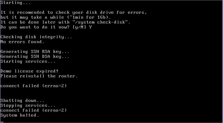

I’m not sure what’s going on, but when I installed RouterOS in VirtualBox 3.25 it crashed before any screen output. I tried installing it in Qemu and this is what I got. This was a 100% zeroed out drive with NOTHING on it.
And what’s that connect failed mean? Is this software phoning home oh Mikrotik?
didn’t you install XEN package?
No I have not tried Mikrotik under Xen. Is the Mikrotik now only supported under Xen? I’ve always been able to run some previous version of RouterOS in both VirtualBox and Qemu with no problems. I’m just confused as to what’s going on with RouterOS and why things keep breaking it seems?

I know that 3.24 (and maybe 3.25… maybe not =) don’t remember… ) when installed w/o a key but with xen package shows ‘Demo license expired!’ immediately after install

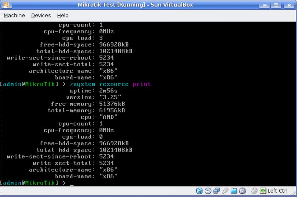

I was able to install RouterOS 3.25 in VirutalBox 2.2.4 only with the VT-x/AMD-v turned on and if the BIOS supported hardware visualization, but I couldn’t get any of the Intel virtual NICs working (had to use PCnet). The original machine didn’t support hw virt. In both installs, the “Xen” package was not checked on RouterOS.

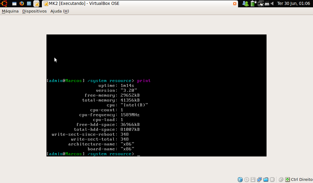

I have no ideia what’s wrong with ROS 3.25. I just can’t run in my VBOX, it turns off without any message.
But I found in my files, the ROS 3.20, and it work pretty well. I’m using my Netbook Aspire One, with Ubuntu Remix to test it. :laughing: This version, show my network card and my wlan card. (wlan working like network).
You just need to enable the PAE/NX in VirtualBox and disable the ZEN package on router os installation.

I’m using VBox 2.2.4 r47978 and Kubuntu 8.04.1 on a Dell D531 laptop. It’s an AMD Turion64 X2. Virtualization is Enabled in the BIOS. Installed ROS 3.25 fresh from the ISO. As mentioned, I couldn’t get the Intel virt NICs working, (the nic would show up but no DHCP responses or anything), PCNet seemed to work fine. I installed all packages in ROS except (routerboard,*-test,xen).
I had all problems mentioned above, but turning ON virt. in the BIOS seems to have fixed all problems.

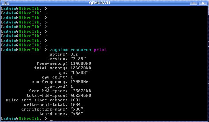

I just got done testing KVM (QEMU PC emulator version 0.9.1 (kvm-62)) with Mikrotik ROS 3.25 and got it working using the -cpu switch set to anything except qemu64. Even though I’m on Kubuntu 32-bit, it appears that KVM sees the AMD X2 and automatically attempts to run with qemu64 cpu for any guest VMs. Also instead of using qemu-create to generate the image, I used dd if=/dev/zero to create my vm raw image.
Here is the command I run to get it working (after running ROS installer):
sudo kvm -cpu qemu32 -m 128 -hda /VirtualMachines/qemu/mikrotik.img -boot c
