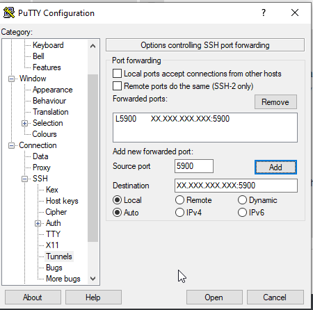

Here’s our situation: We have a bunch of stores, and each store has a Mikrotik router managing the network, which is divided into Trusted and Untrusted networks, fairly standard. Every machine my departement sends out (I am in IT) we put TightVNC on so that we can access it fairly quickly should the need arise. TightVNC is especially crucial with the computers we use with advertisement screens, as store employees aren’t trained to fix those issues.
Everything was fine two months ago, but as Mikrotik has started updating itself to 6.47, 6.49 and so on we’ve noticed that we can no longer access any of the untrusted computers on the network managed by Mikrotik.
Our method was simple: we use PuTTY to set up a tunnel to the computer we want to control via Mikrotik’s IP, and mirror the VNC port on the target computer to a port on our own. By doing this we are able to connect to the remote computer via localhost:5900. I have attached a dummy example image of our tunnel setup.
This worked for the first month I worked here, but since late August things have started falling apart. We’re blocked out of almost every untrusted computer running a mikrotik version greater than 6.44. Most 6.44 connections I tested while writing this works fine. Beyond that, the most common error is this, which appears when you try to VNC to localhost:5900:
PuTTY Fatal Error
Recieved SSH2_MSG_REQUEST_FAILURE with no outstanding global request.
Followed by the connection closing and putty going inactive. I’ve seen this error dozens of times across different stores and despite my best efforts I’ve never been able to figure out what exactly goes wrong. It seems to be an obscure bug.

What does /ip ssh export show on those routers? The port forwarding became configurable since some ROS version:
[me@myTik] > ip ssh set forwarding-enabled=
ForwardingEnabled ::= both | local | no | remote
remote – allow clients to listen on server and forward incoming connections
local – allow clients to originate connections from server
And the default is no.
The PuTTY error you get appears when you try to activate port forwarding that the server doesn’t permit.

/ip ssh
already on 6.34.6: always-allow-password-login forwarding-enabled strong-crypto
added on 6.36.x: host-key-size
added on 6.44.x: allow-none-crypto
changed on 6.45.x: allow-none-crypto change default value from yes to no
changed on 6.45.x: forwarding-enabled change default value from remote to no
