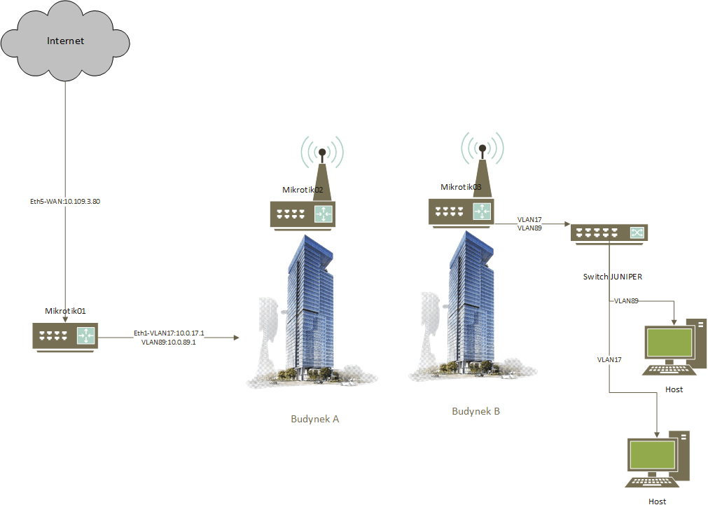

Hi everyone !
I have a problem, I want to configure mikrotiki (Router, transmitter and receiver). The problem is to do it in such a way that from the administrative level (vlan89) you can "see" these devices, but from the client vlan level (vlan17) you cannot see the receiver and transmitter, and this is where the problem arises. I want to configure Vlan so that the router to the transmitter is tagged and also tagged from the transmitter to the receiver, but from the receiver so that untagged frames go to the client's host via the ether1 port (for security purposes, the client does not see the antennas at all and only has access to Internet.. Only the administrator should have visibility of all devices). What should you do to meet these guidelines?
Here is the configuration of my devices:
Router (main):

What your missing is that each smart device should get an IP from a management vlan.
Data vlans 17 and 89 are carried forward to each smart device as well.
Assuming that the ROUTER has its own internal LAN, wheras, the receiver/txitter are acting solely as AP/switches and do not need an internal LAN so to speak.
You forget as the last rule change to make bridge vlan-filtering=yes.
There is no such bridge or wlan port called LAN, so first entry in /interface bridge ports should be removed!!!!!
Bridge needs to be tagged in /interface bridge vlans
Ensure you identify the out interface for source nat.
WAN port is not normally on bridge.....
WHY on WHY do you have IP DHCP client set to LAN bridge.......
It looks like you are getting a private IP address from an upstream modem router.......... no need for dhcp client (aka disabled) if you have put a static IP address for it. You will also need to add a manual route......
Highly recommend you do config on each device OFF bridge -see next ( okay your two rx, tx devices only have a single port, make sure you use safe mode to make changes. )
OFF Bridge ( for all three MT devices for configuration and emergency access )
  • take one port off the bridge
  • give it an IP address anything add address=192.168.55.1/24 interface=etherportX network=192.168.55.0
  • add it to MGMT Interface as a member
  • put static ipv4 setting on pc as 192.168.55.5 for example and you should have access.
  • I have ether1as being local LAN access port, ether2 is a local access port for management network, ether3 trunk port going to MT TX, ether4 off bridge, ether5 is WAN
    Main differences for RX/TX from router.
    No dhcp,
    Only management vlan is tagged on bridge
    Only management vlan is defined
    Every smart device gets its IP address on the management vlan
# model = RB750GL
add admin-mac=4C:5E:0C:D7:C2:74 auto-mac=no comment=defconf name=LAN-Bridge vlan-filtering=yes
add name=WAN
add name=LAN
add name=MGMT
set [ find default-name=ether1 ] name=LAN1
set [ find default-name=ether2 ] name=Mgmt2
set [ find default-name=ether3 ] name=TRUNK3
set [ find default-name=ether4 ] name=Off-Bridge
set [ find default-name=ether5 ] name=WAN5
/interface vlan
add interface=LAN-Bridge name=vlan17 vlan-id=17
add interface=LAN-Bridge name=vlan89 vlan-id=89
add interface=LAN-Bridge name=Home20 vlan-id=20
add interface=LAN-Bridge name=MGMT99  vlan-ids=99
set discover-interface-list=MGMT
add  interface=Vlan-MGMT  list=MGMT
add  interface=Vlan-MGMT  list=LAN
add interface=vlan17  list=LAN
add interface=vlan89  list=LAN
add interface=Home20  list=LAN
add interface=WAN5 list=WAN
add name=dhcp_vlan17 ranges=10.0.17.100-10.0.17.150
add name=dhcp_vlan89 ranges=10.0.89.100-10.0.89.150
add name=dhcp_vlan99 ranges=10.0.99.100-10.0.99.110
add name=dhcp_main ranges=10.1.1.1-10.1.1.253
add address-pool=dhcp_vlan17 interface=vlan17 name=dhcp1
add address-pool=dhcp_vlan89 interface=vlan89 name=dhcp2
add address-pool=dhcp_vlan99 interface=MGMT99 name=dhcp99
add address-pool=dhcp_main   interface=Home20 name=dhcp3
add bridge=LAN-Bridge comment=defconf interface=LAN1  ingress-filtering=yes  frame-types=admit-only-priority-and-untagged  pvid=20
add bridge=LAN-Bridge comment=defconf interface=Mgmt2  ingress-filtering=yes  frame-types=admit-only-priority-and-untagged  pvid=99
add bridge=LAN-Bridge comment=defconf interface=TRUNK3  ingress-filtering=yes  frame-types=admit-only-vlan-tagged
add bridge=LAN-Bridge tagged=LAN-Bridge  untagged=LAN1,  vlan-ids=20
add bridge=LAN-Bridge tagged=LAN-Bridge,Trunk3  untagged=Mgmt2,  vlan-ids=99
add bridge=LAN-Bridge tagged=LAN-Bridge,Trunk3  vlan-ids=17,89
add address=10.109.3.80/24 interface=WAN5 network=10.109.3.0
add address=10.1.1.254/24  interface=Main20 network=10.1.1.0
add address=10.0.17.1/24 interface=vlan17 network=10.0.17.0
add address=10.0.89.1/24 interface=vlan89 network=10.0.89.0
add address=10.0.99.1/24 interface=MGMT99  network=10.0.99.0
/ip dhcp-client
add comment=defconf  disabled=yes
add address=10.0.17.0/24 dns-server=10.0.17.1 gateway=10.0.17.1
add address=10.0.89.0/24 dns-server=10.0.89.1 gateway=10.0.89.1
add address=10.1.1.0/24 dns-server=10.1.1.254 gateway=10.1.1.254
add address=10.0.99.0/24 dns-server=10.0.99.1 gateway=10.0.99.1
set allow-remote-requests=yes servers=1.1.1.1,8.8.8.8
add dst=0.0.0.0/0 gateway=10.109.3.1 routing-table=main
/tool mac-server
set allowed-interface-list=MGMT
/tool mac-server mac-winbox
Remove static IP DNS from default settings.
Remove any ipv6 noise
no need for firewall, nat any router stuff...........
Transmitter:
feb/23/2024 05:20:13 by RouterOS 6.49.8
# model = 911G-5HPacD
add name=TX-Bridge vlan-filtering=yes
set [ find default-name=ether1 ] name=TrunkPort-TX
/interface wireless
set [ find default-name=wlan1 ] antenna-gain=2 band=5ghz-onlyn channel-width=\
20/40mhz-Ce country=poland disabled=no frequency=auto installation=\
outdoor mode=bridge nv2-preshared-key=test1234 nv2-security=enabled \
radio-name=JPII ssid=MikroTik wireless-protocol=nv2
/interface vlan
add interface=TX-Bridge name=vlan-MGMT vlan-id=99
add name=MGMT
/tool user-manager customer
set admin access=\
own-routers,own-users,own-profiles,own-limits,config-payment-gw
add bridge=TX-Bridge interface=TrunkPort-TX ingress-filtering=yes  frame-types=admit-only-vlan-tagged
add bridge=TX-Bridge  interface=wlan1 ingress-filtering=yes  frame-types=admit-only-vlan-tagged
add bridge=TX-Bridge  tagged=TX-Bridge,TrunkPort-TX,wlan1   vlan-ids=17,89,99
add address=10.0.99.2./24 interface=vlan-MGMT network=10.0.99.0
set allow-remote-requests=yes servers=10.0.99.1
add dst-address=0.0.0.0/0 gateway=10.0.99.1  routing-table=main
/tool mac-server
As per above, VLANs are not etherport or WLAN ports and not set in /interface bridge ports
Receiver (client side):
# feb/23/2024 04:47:20 by RouterOS 6.49.8
# model = 911-5HnD
add name=RX-Bridge vlan-filtering=yes
set [ find default-name=ether1 ] name=TrunkPort-RX
add authentication-types=wpa-psk,wpa2-psk mode=dynamic-keys name=\
mikrotik_conn supplicant-identity="" wpa-pre-shared-key="papie\BFak69!" \
wpa2-pre-shared-key="papie\BFak69!"
/interface wireless
outdoor mode=station-bridge nv2-preshared-key=test1234 nv2-security=\
enabled radio-name=JP2 security-profile=mikrotik_conn ssid=MikroTik \
/interface vlan
add interface=RX-Bridge name=vlan-MGMT vlan-id=99
add name=MGMT
add bridge=RX-Bridge  interface=TrunkPort-TX ingress-filtering=yes  frame-types=admit-only-vlan-tagged
add bridge=RX-Bridge  interface=wlan1 ingress-filtering=yes  frame-types=admit-only-vlan-tagged
add bridge=RX-Bridge  tagged=RX-Bridge,TrunkPort-RX,wlan1   vlan-ids=17,89,99
add address=10.0.99.3/24 interface=vlan-MGMT network=10.0.99.0
/tool mac-server
Thank you very much for your clarification
