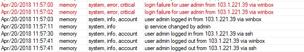

I noticed today an unusual login to my router and it create file in router os file.(Attached)
First some body login from 103.1.221.39 . And some how they cracked my password. Please check attached image. After that they enable ssh and telnet.
I upgrade the router on latest bugfix. 6.40.7
Its a very serious issue.
i got a file save.sh in file.
You should not allow login to your router from the internet! Fix your firewall configuration…
Problems like this should be reported directly to support@mikrotik.com
NEVER allow management on your devices from internet. Fix your firewall.
Pick a strong password, took only 3 seconds according to your log …
