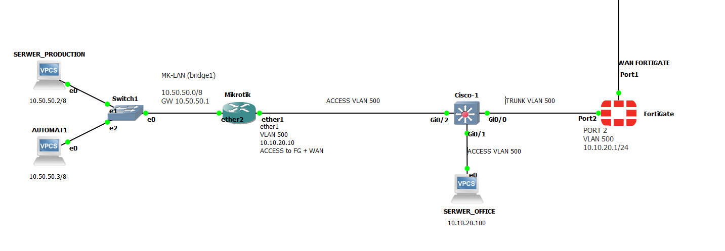

Hello I’m new here on Forum, also new with Mirotik solution too.
In GNS I’ve Fortigate, Cisco SW, Mikrotik
Port description
Fortigate:
Port1 = “WAN”
Port2 = VLAN 500 10.10.20.1/24
Cisco SW
Port1 = Trunk to Fortigate (Fortigate port2)
Port2 = Virtual PC1 IP: 10.10.20.100/24 GW 10.10.20.1
Port3 = Mikrotik
Mikrotik
Port2 = “WAN” Link coming from Cisco IP: 10.10.20.10/24
Port3 = Virtual PC IP 10.50.50.2/8 GW 10.50.50.1 (this subnetwork is created on Mikrotik)
Port 3 is only part for bridgeLAN
On Mikrotik side all connection/routing/addresses list they are coming from Cisco/Fortigate are automatically, I do not set any static stuff.

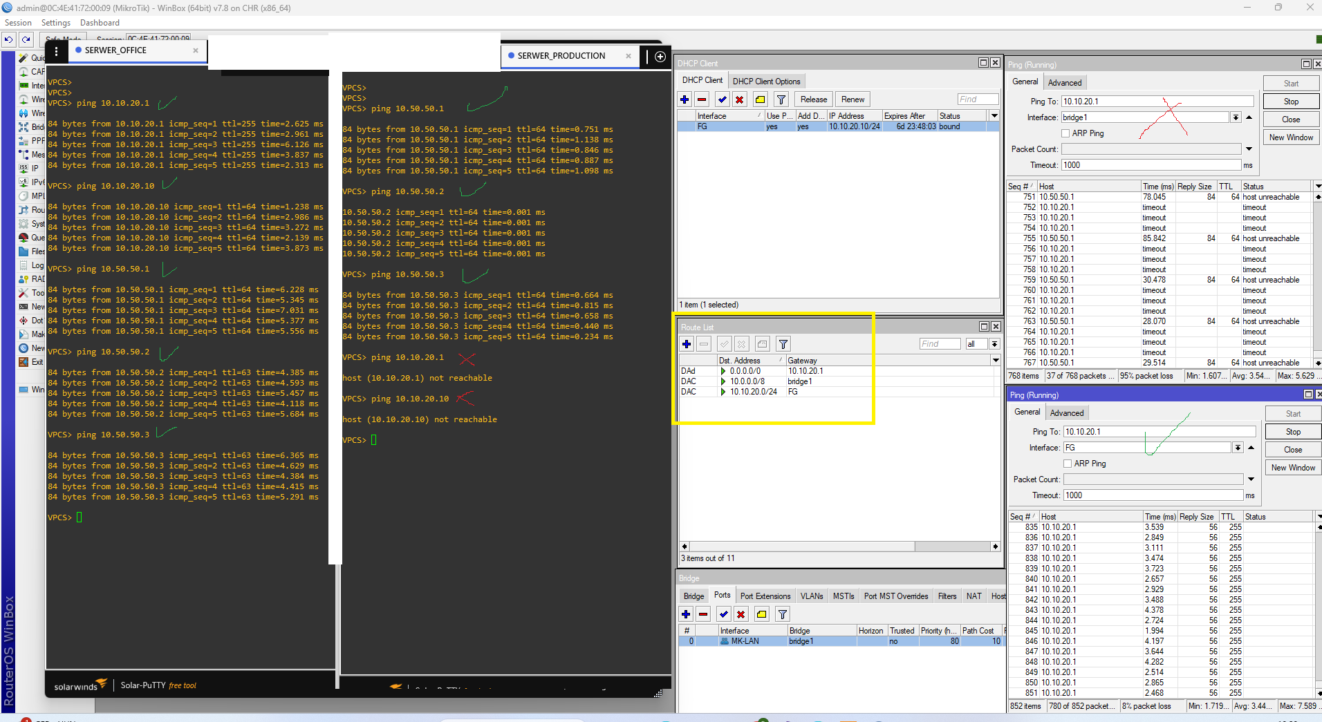

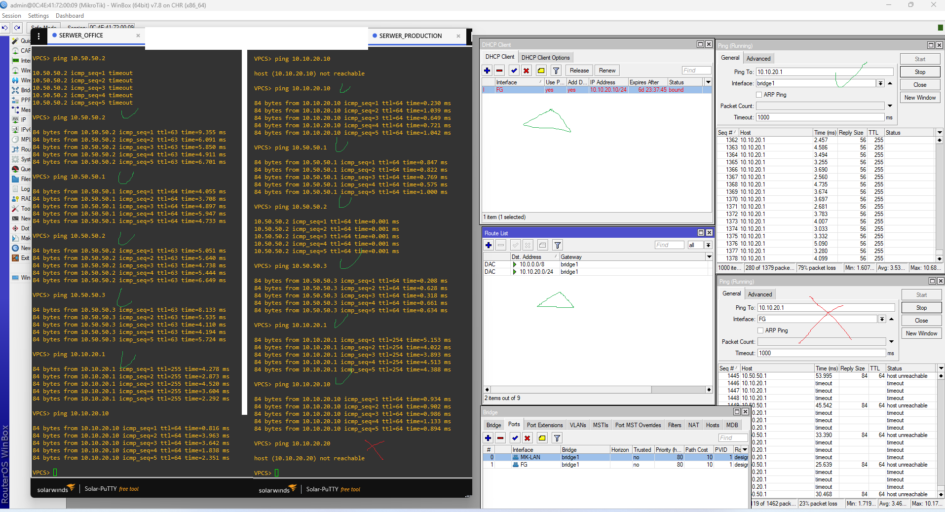

Hello anav and, thank for your reply
I had play little bit with configuration, seems it work.
The one thing what I change was bridge, on Mikrotik I named two interfaces one:
FG (link from Fortigate)
MK-LAN (LAN on Mikrotik)
On beginig in bridge1 was only MK-LAN, then pings works from FG to MK but not reverse
When i moved FG to bridge1 too and deleted one default routing was created automaticly the pings works in both directions.
I prepared some pictures, this configuration is ok from “network” poerspective on mikrotik? Or this can give some trouble in the future?
