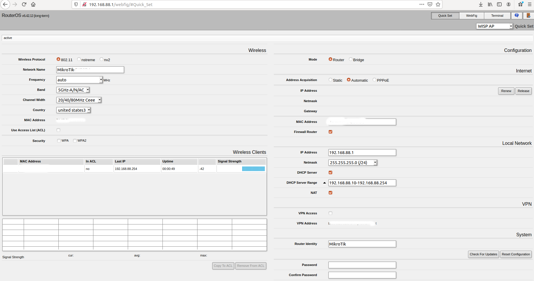

Below is a screenshot. Seems to say I am doing WISP
Look at the mode setting, its says router NOT bridge as I noted to look for in post #6 above LOL.
Ha, indeed. So that’s the default setting, and I admittedly did not update this earlier; just went right into WebFig and did the steps as I outlined in the first post:
