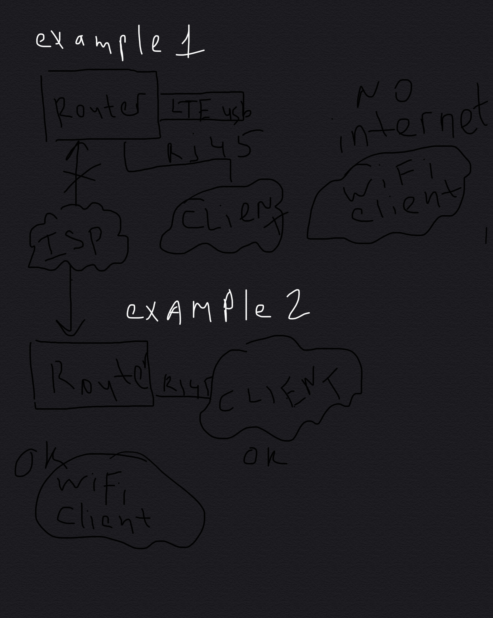

Draw a simple diagram…
I use a router with rj45 cable ISP but sometimes I should use USB modem with this router, because ISP not stable.
When I lost ISP of cable internet, USB modem helps to my router be online. But when it’s happened, I lost WIFI clients

First, i do not see your Wlan inside the Bridge Interface, So how is your client cofigured…?
I do not see any address assigned to the wlan interface as well, since it is not inside the Bridge…
Also since you use DHCP Client to get internet from the ISP, the only case you switch to the LTE is to manually change the distance or completelly power off the ISP’s Router or it will never work as failover…
Or you must create a recursive failover…
1)clients receive internet by DHCP
How could i add wlan to brige correctly? i dont known how, but everything ok if i use cable ISP(
Just add it to your bridge ports as you would do with any interface…
Thanks for your help, my friend. Everything works good now. Problem also was in DHCP server. Somehow it’s died. I’m downgraded to bag-fixed fw, then setup all from zero point) all good.
Thanks one more time!
