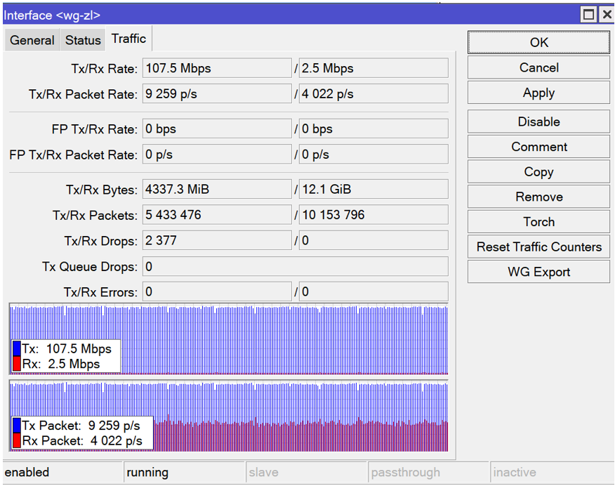

when transferring large files from Site-A to Site-B (read "with constant maximum channel load") errors appear...
Tx Drops errors are only on the "wg" (Wireguard) interface on Site-A.
The error rate is 0.02% - 0.07%, i.e., "conditionally averaged" is from 2 to 7 "drops" for every 10,000 transmitted packets.
At the same time, absolutely all other interfaces have no errors at all.
Transmission in the opposite direction does not lead to any errors.
Errors occur completely randomly, without any pattern (most likely this is a manifestation of the "backbone" channel variation).
It seems that this is due to the difference (300/100) of the bandwidth of Site-A and Site-B.
I'm thinking that this can probably be solved by some kind of "buffering" via queues and the like...

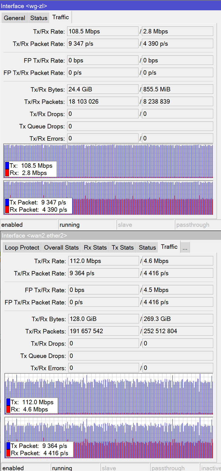

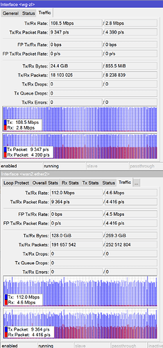

I ran a number of more tests and finally made sure that this was due to the packet buffering rules in WireGuard.
The external WAN interfaces work flawlessly despite the difference in channel speeds and loading, as can be seen from traffic data and graphs.
Therefore, the WireGuard interface cannot transfer the packet to the WAN-int and discards it.
Perhaps this can be solved by increasing the buffer of the WAN-int to receive packets from WireGuard, but I do not yet know how to do this correctly.
So let it work as is, and I will try to study/understand if it is possible and how to set up buffering correctly.:wink:

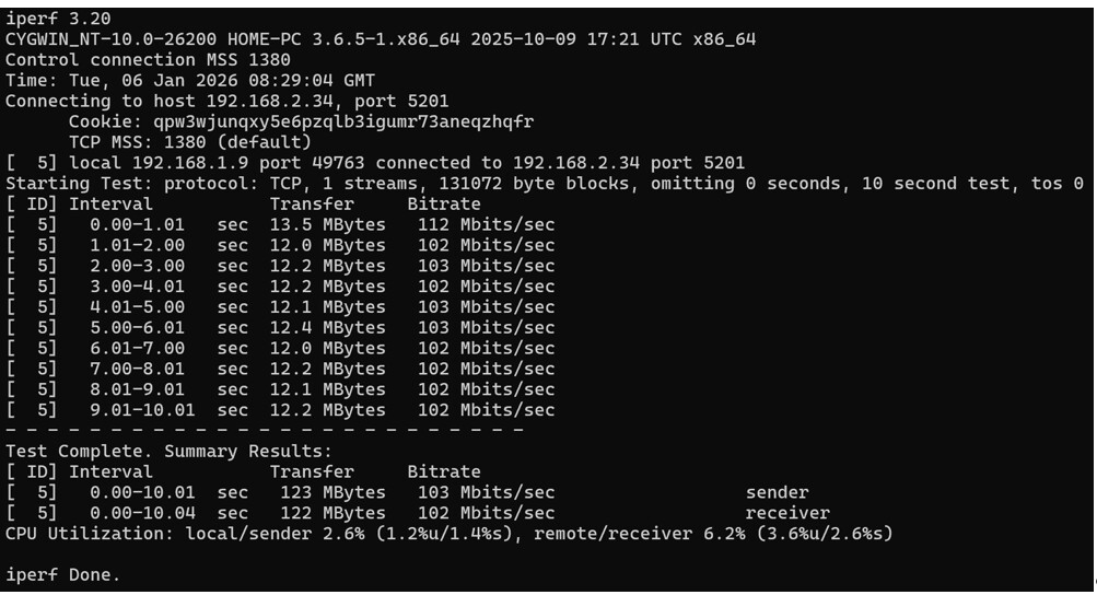

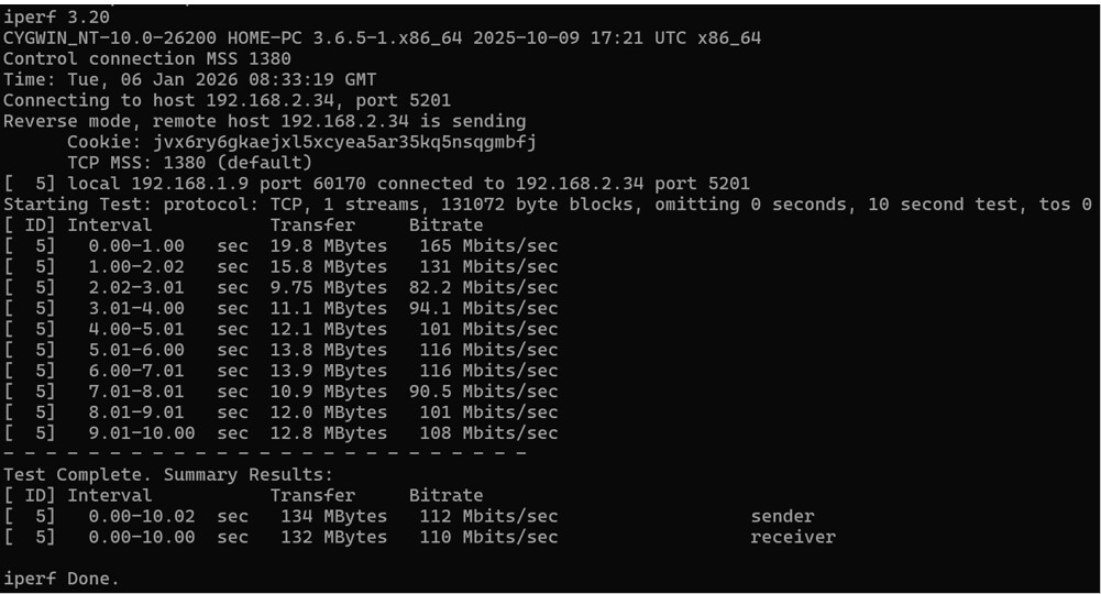

Some tests results are attached below.
Data sending from Site-B to Site-A ( 100Mbps >>> 300Mbps)
Data sending from Site-A to Site-B ( 300Mbps >>> 100Mbps)
iperf3 test results:
Host 192.168.1.9@Site-1 (iperf3 client) & host 192.168.2.34@Site-B (iperf3 server)
Send from Site-A to Site-B
Send from Site-B to Site-A
The problem is solved!!!

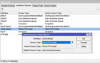

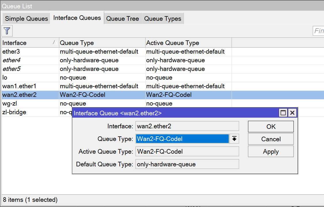

It seems to be the WireGuard@Mikrotik does not have the ability to programmatically configure queues. At least I didn't find it in the documentation or on the CLI. And there is not even a mention of such a possibility.
Therefore, there is only one way left - to set up the correct queue on the Wan interface.

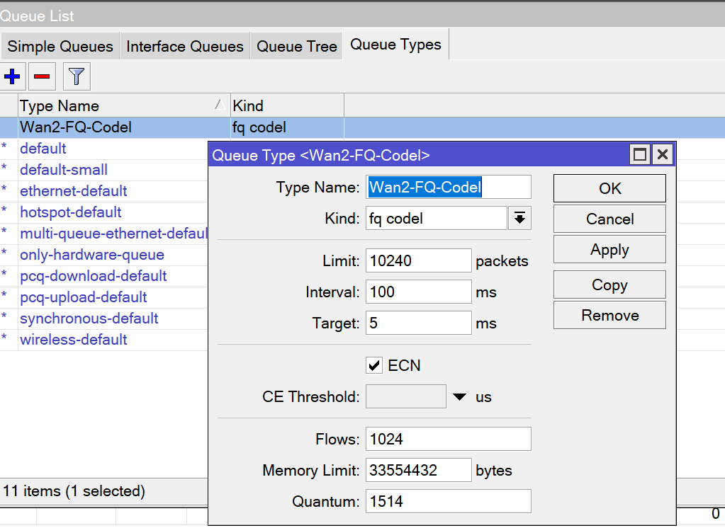

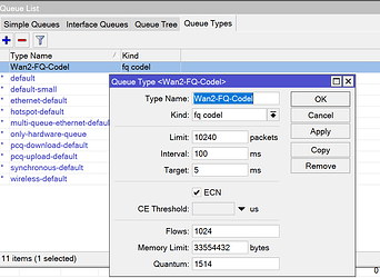

I decided to start with "smart" queues.

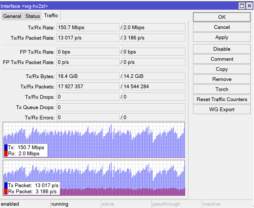

Changing "multi-queue-ethernet-default" to "FQ-CoDel", with default settings, solved all the issues!
Test with transmission of > 18M packets - 0 errors!
:grinning_face:

I'm interested by your solution. Can you provide your queues cfg ?

And queues:
  1. Create FQ-CoDel
  1. Assign
I think thatโ€™s all :slight_smile:
