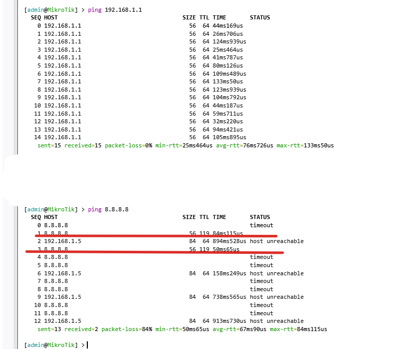

1.by flapping we mean this:
As you can see connection to main router (ZTE 192.168.1.1 is ok) but when I’m trying pinging 8.8.8.8 only two packets have been received but rest are timeout or host unreachable2.2026-01-02 16:52:05 by RouterOS 7.20.6

The picture you posted tells little about the quality of the wireless link, as a matter of fact, the pinging to 192.168.1.1 seems fine, is the pinging to 8.8.8.8 that is flaky and that could be this (or that) configuration issue.

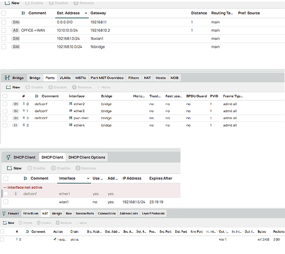

I still don't understand how your wireless connection Is working, but you have a route with gateway 192.168.1.4, if the zte Is the gateway, that should be 192.168.1.1.
But you don't have seemingly any interface with IP address in that range, so that's another mistery, your device seems configured as router, while likely you want a bridge instead.
Post the output of
/ip route print
and
/ip address print
About a "faster" Mikrotik device, you would need two of them, so some money would be needed, a hap lite (or a mAP lite or anyway a "previous generation" one) can usually be found for around or less than 20 € or so.

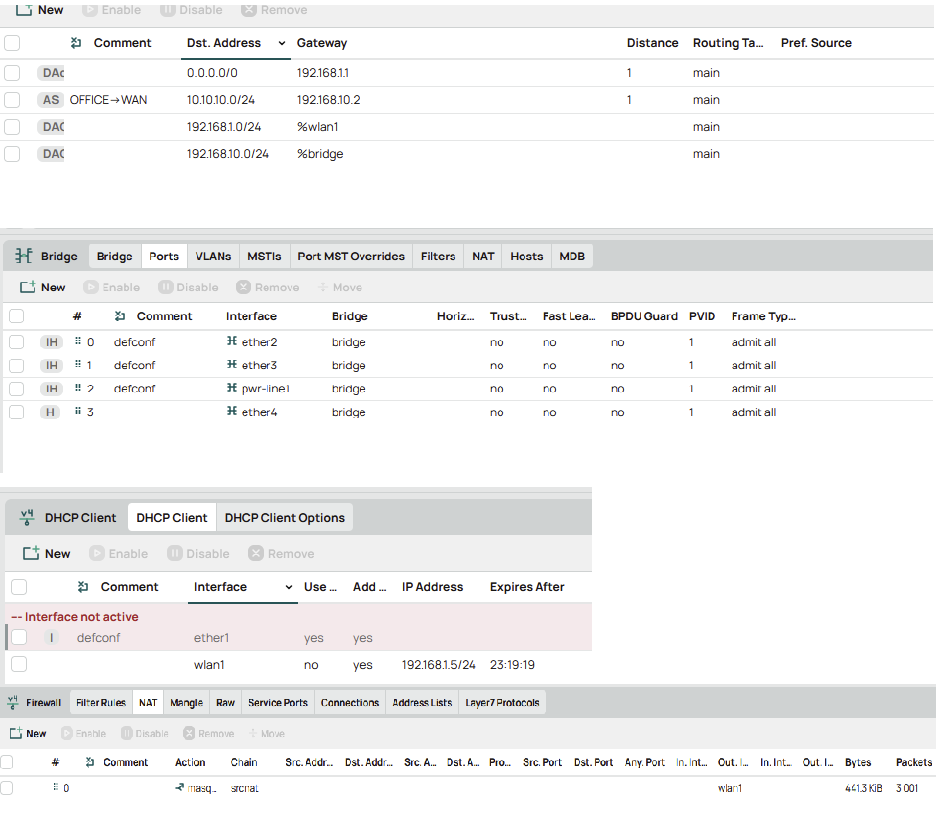

jaclaz you have right, by mistake I set 192.168.1.4 as gateway. I corrected this route:
If I good understand my configuration looks like:
ZTE(192.168.1.1)-(mode:station)->(wlan1 -192.168.1.5)- mikrotik-(ether4-192.168.10.1)->(wan1 - 192.168.10.2) fortigate 60d(int1-VLANS 10,20,30)->(trunk)switch l3->hosts,printers etc.
Currently
Mikrotik pinging 8.8.8.8, 192.168.1.1, 192.168.10.2, 10.10.10.3 (OFFICE)
Firewall pinging 8.8.8.8, 192.168.1.1, 192.168.1.5, 192.168.10.2, 10.10.10.3
Host (10.10.10.3) - pinging 8.8.8.8,192.168.1.5, 192.168.10.1, 10.10.10.1

Maybe now I see, you are setting the ZTE as 'station" and then you have the hap lite setup as AP (and as router).
Usually the roles are inverted (the AP Is on the side connected to the internet, and the station Is on the side of the clients) but I don't think that this can have any adverse effect.
But the hap lite Is routing the connection.
This implies double NAT and only L3 connectivity, these could be just fine, of course.
