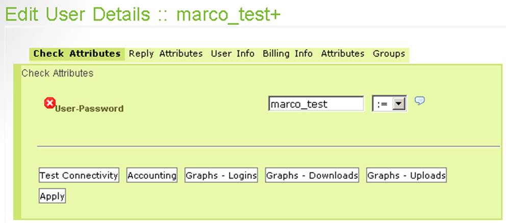

We have installed 50 RB411 using PPPoE client connexion our PPPoE Server have a Daloradius Server to allow/rejected all request.- At the moment we only use the Daloradius to assigned the rate limit and work fine because after to assigned the rate limit we go to Mikrotik/Winbox/QUEUE and we can see this queue.- Right now we need to know how we can assign the static IP address.
We spoke with Daloradius development and he recommend as that we speak with Mikrotik to find what is the value that we need to send back across to Daloradius example:

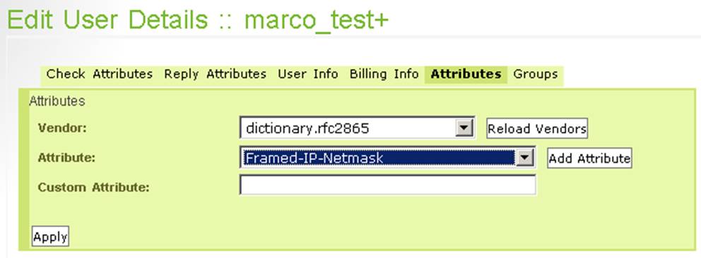

We found on Daloradius the following dictionary that we guess that we can use but now work.
dictionary.rfc2865 Framed-IP-Address
For this reason can you send me back any commentaries how we can configure on the Daloradius the options that permit assigned any static IP
The question is: How I can Assigned using Daloradius a Static IP Address across the vendor list.?
Best regards,
yes, you should simply send ‘Framed-IP-Address’ attribute to assign that address to the user
