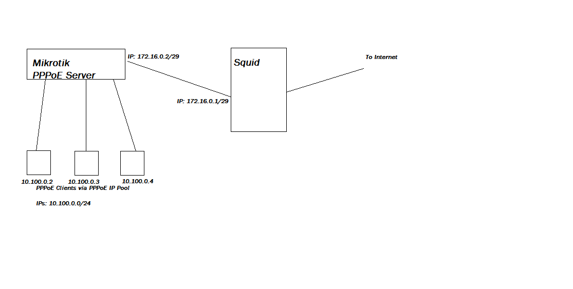

Hi I would like to use Mikrotik with an external Squid transparent proxy.
I would however like to know, how do you setup the forwarding rules on Mikrotik so that the IP of the user is passed to the squid. If you do a normal dstnat rule the Mikrotik passes its own IP to squid.

If the router is used as a proxy with a parent proxy set the packets MUST have the source IP address of the router, that’s how chained proxies work.
If you’re destination NATing to the Squid proxy directly and the router source NATs the packets to itself then it’s doing so because you specifically told it to do so in the source NAT rule set. Reconfigure your ruleset so that it stops doing that. If you need help with that please post a network diagram with IP addresses and device names, and the output of /ip address print detail", “/ip route print detail”, “/interface print”, “/ip firewall export”.
Hi Thanks for the reply
Here is the IP addresses detail:
0 address=10.100.0.1/24 network=10.100.0.0 broadcast=10.100.0.255 interface=ether1 actual-interface=ether1
1 address=172.16.0.2/29 network=172.16.0.0 broadcast=172.16.0.7 interface=ether2 actual-interface=ether2

Your only option is to remove the masquerade rule and do all source NAT on the Squid box, or to introduce another NAT router behind the squid box. If all traffic goes through the squid box anyway why are you destination NATing at all?
