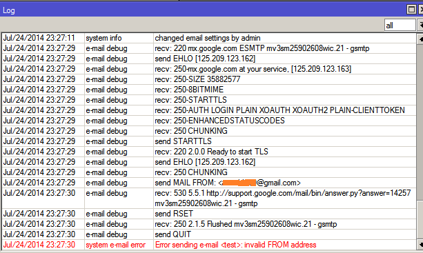

I have tried every one suggestions , but no results, I still get INVALID FROM ADDRESS. It seems its picking subject as a from address, strange. If I change subject, it gives this address as invalid from address.
As showed in the image below…

Are you read the link inside your log???
http://support.google.com/mail/bin/answer.py?answer=14257
Get to your Gmail account’s security settings and set permissions for “Less secure apps” to Enabled.

Is not one issue, gmail one day decide to mark as insecure all the clien who are not supporting some crypto protocols.
6.x as the new protocols, but on 5.x are not presents and for this are considered unsecure.
Simply go on gmail and change the option as I write before.
