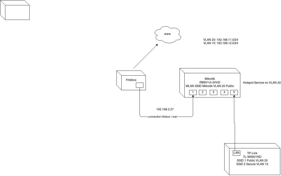

I have the following scenario :
The TP- Link has the following SSIDs
SSID with VLAN 1 Public 20
SSID 2 Secure with VLAN 10
the TP-Link is connected to the at Mikrotik Ether5 slave.

Does anyone have an idea what I need to set exactly on the Ether5 , so that the two VLANs are treated separately accordingly?

we solved the problem.. we changed to ubiquiti wlan ap
bridge-local → Port 5
bridge-vlan10 → vlan10-interface, port 2 3 4 and wlan
bridge-vlan20 → vlan20-interface private wlan
hotspot-service works on bridge-vlan10
dhcp has one pool for bridge-vlan10 and one pool for bridge-vlan20
and now it works great
