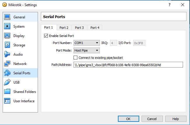

I’m using free version of mikrotik (x86) platform running through Oracle VirtualBox virtualization software and GNS3.
Everything is fine, but i can’t get console to the mikrotik device, although i have enabled guest remote console checkbox in the GNS3 software.
When i press the console button in GNS3 i get console is available, press return to continue, but nothing’s happen when i push it.
I have same problem with classic Debian installation, but i’ve followed this tutorial and now i’m able to see the console through serial connection.
i’ve just fixed the problem. I will share my experience here to help to another users.
Just have to add serial console to available terminals.
