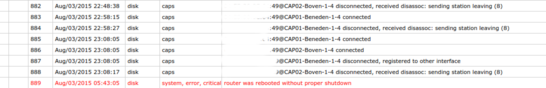

For several years i`m using a RB450G without any issues but since i connected two hAP Lite units and enabled CAPsMAN it seems to reboot from time to time . Or when my wifi stops working i need to reboot the RB450G to get the wifi working again.
Last night (25-07-2015 01:25) i rebooted the RB450G because of this wifi issue`s but now i found out that logging also stopped working. The clock seems fine and is equel to the local time but the lost logrule is dated 24-07-2015 09:30:41 :open_mouth:

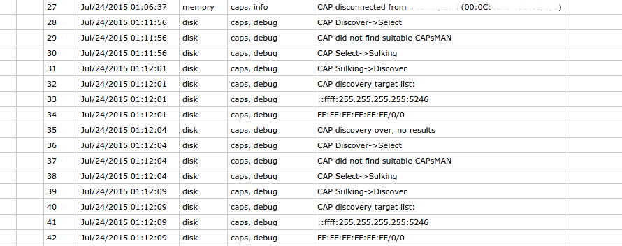

This is a snippet from one CAP which has CAP DEBUG logging enabled :smiley:
I have replaced the RB450G with a new board and power supply and the issue still remains. I have upgraded the units to 6.30.2 (RB450G and the hAP lites) but the issue occurred again last night. There are no schedules for the timeframe in which the crash occurs and Nagios told me the issue started on 08-03-2015 23:11:49
