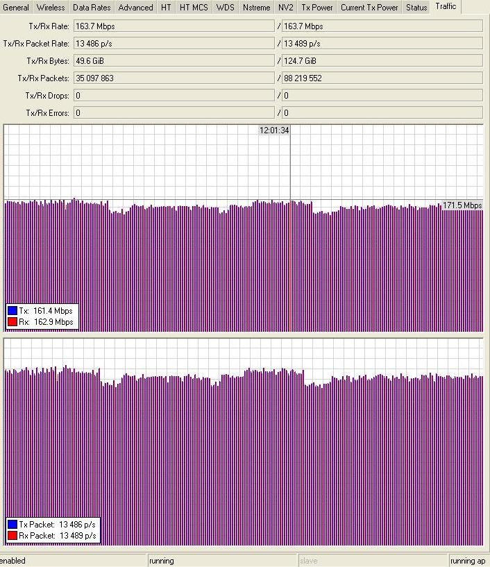

Last week, at inet-meeting Cyberbajt presented his new Mimo 3x3 products.
Pretty impressive results, I think. With new Atheros AR93x0 chipsets, MikroTik becomes fastest WiFi solution, in this price segment.
Nice alternative for high throughput p2p links. :smiley:

Above test was made with Cyberbajt 19dB Mimo 3x3 antenas at 500m link. Signals about -60 for all 3 chains. CCQ about 90%
Today we move this link to 4km, but signals are to low. Max transfer is 60Mb with signals about -77. Maybe if we change cards for more powerfull models, link will get better.
I’ll write here more information tommorow.

After few tests - I can write some conclusion. Cards are awsome :slight_smile: With good antennas can work with more than 200Mb real network throughput. In bad envoironment, where much noise is, cards work better than old MIMO 2x2. They can work with QAM16 modulation with higher MCS.

I’ve just tested new antennas, and I see big improvements. New project is also 19dB, but diferent design. Test link at 850m can work with 150/30Mb (43k pps/12kpps) real network troughput. (TX-Power is set for 3 for both sides, NV2 is enabled, signals about -55) Ping is about 3..4 ms. I think MT software need some improvements, because link default sets to MIMO 2x2 MCS, and I have to manualy set only 3 chains MCS. There is a problem with QAM64 MCS for 3 chain’s, and now I don’t know is it problem with software or with antennas… Maybe new nv2 package will work better, but I can’t try it, because MT developers didn’t respond for my mail.
