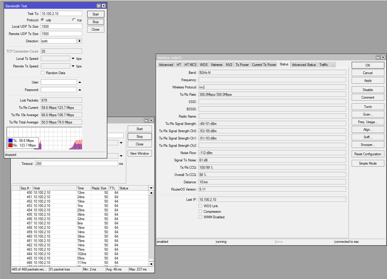

Slightly OT. I have just started setting up a link with NV2. It is 8km. Both ends UBNT 30 db dishes. The problem is I see very bad latency and jitter when the link is idle or close to idle. Is this normal?
With NV2 I get 300/300 100%/100% ccq. Even with some minor traffic latency is still very bad and jittery. However the throughput is incredible!
This is only with 2x2 MIMO mode. Running single chain it seems fine.
Oh I am running r52hn cards and rb411ah on one and and rb411u (non AH) on the other end. Could that affect anything not running the faster CPU on one end?
Turn your power down (both sides, small increments, down to -70) and test to see if it helps.
