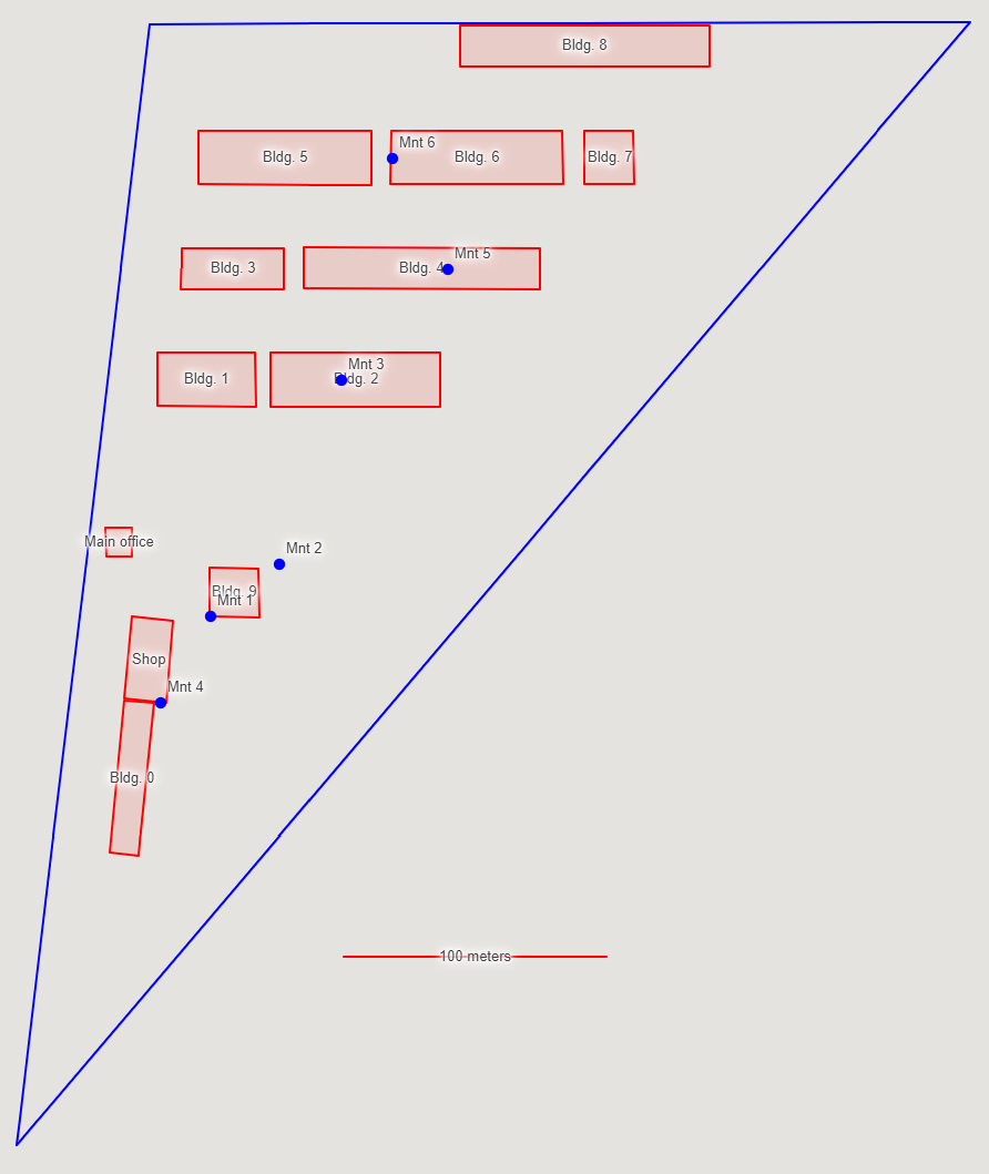

I have a project to provide basic wireless internet to an area of about 7 hectors/17 acres for a local club. This is a rural, flat location with metal buildings. Other than the buildings there are no obstructions on the property. Internet is currently provided by DSL at 30/3 Mbps, although this will be raised in the next few years when fiber is installed along the road. I do not see a need for greater than 100 Mbps capability on the network. The normal “population” of wireless clients will be 20-30 at peak times on the weekend with a max of 75-100 for events. There are a few laptops and tablets, but most devices are just phones. It is not expected that this network provide a high level of service for video streaming to devices, etc. It is just for basic connectivity for text messages, checking email, and occasional website visits.
A challenge is that it is not feasible for physical cables to be run between buildings. Distribution must be done by RF links. There are several mounts that are already in place that are ideal for adding APs as these locations already have a weatherhead to allow easy passage of cables into the building for power. At this point there is no requirement for wireless inside the buildings, just covering the outdoor areas around the buildings. Some individual members have their own “repeaters” for connection inside the metal buildings if they want it, the club might support this further in the future, but not at this time. The initial budget is up to $3,000 USD for hardware.

Graphic explanation:
  • Blue outline is property boundary
  • Red outlines are building footprints
  • Blue dots are easy antenna mounting locations
Current setup:
  • DreamMachine inside main office
  • Unifi Mesh Pro AP at Mnt1 (Good connection)
  • Unifi Mesh AP at Mnt2 (Okay connection drops 1-3 times/day)
  • Unifi Mesh Pro AP at Mnt 3 (Poor connection drops 1-2 times per hour and bounces between direct connection to DreamMachine and relay via Mnt 2)
Thoughts on future setup:
Mnt1, Mnt2, and Mnt3 all have direct line of sight to the office. The area around the office is also the most used area. I am thinking of a sector antenna for RF links and users around the office with directional antennas at those three mount locations to connect back to the office. Each Mnt location could then have an omnidirectional or sector antenna. Mnt5, and Mnt6 both have line of sight to Mnt3.
It seems to be best practice that the RF links are 5Ghz and the user APs be 2.4 Ghz. With our speeds, should we use all 2.4Ghz, or will it be beneficial for interference at mount locations to have the backhaul be one and distribution to clients be the other?

After doing some more reading/research, I am thinking of starting with a mANTBox 15s as the main base for the system. With that I can cover the three current points that would need to tie back to it. In my initial graphic, Mnt3 has the mesh link that is dropping the most, so I would start there. I will use a PowerBox Pro on that mast fed with a 48V passive PoE from within the building. That will power/connect the backhaul to the main office, the current Ubiquiti Mesh Pro, and a future sector to the north.
Any advice on what to use as a backhaul to the main sector would be appreciated. I am looking at the DISC Lite5, SXTsq Lite5, SXT SA5, (or something else?).
Assuming I use good separation on the 5GHz frequencies and restrict the Ubiquiti Mesh Pro to 2.4GHz, anything else I should be doing to reduce interference of these three devices in close proximity?

There is no convenient place currently to mount on building 8. The blue dots are existing, easy to mount to structures that already are already present, like poles with a TV or radio antenna. More can be added as needed, but I’m eyeing the low hanging fruit first.
