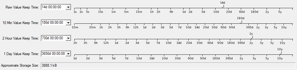

It depends on how many devices you would like to monitor.
For example, I have 8 GB card in my hEX S at home and it is being reported as 7.5 GiB size and 4.7 Gib free. It monitors itself, switch, AP and a router in remote location, including all link speeds and connectivity to 6 services ind the internet. It keeps all the logs forever and data for graphs as described in attached picture (almost forever).
So go ahead and just use your 16 GB card, it should last for a while ![]()
