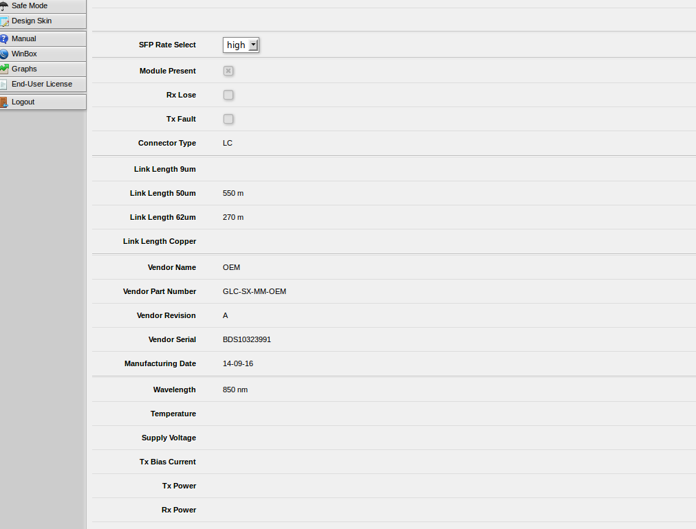

Long story short I purchased a sfp and the information says it has DDM. However, in my Mikrotik the DDM information is blank. I searched and came across someone else on a different Mikrotik product saying the DDM information disappeared after an RouterOS upgrade. The problem is I just purchased this and upgraded to 6.20 and now 6.22 and it never has showed DDM information so I don’t know if it’s just not showing it --OR-- the sfp doesn’t contain DDM. Anyone know how to determine the sfp module contains DDM or throw me a bone here? I Googled and have hit a dead end.
Thanks for the help!!
screenshot:
i think that the cheaper devices like 2011 dont support it …
I had a situation when my crs-125, after initially showing the DDM info.
This happened after pulling out the SFP and plugging it back in.
A simple reboot didn’t help much, but a shutdown, physical power cut (count to 10) and again power on solved the issue.
Maybe it is worth a try…
Thanks for the replies!
I looked at the page for my model and it confirms it supports DDM:
Product specifications Details
Product code RB2011UiAS-2HnD-IN
SFP DDMI Yes
I just unplugged the unit, unplugged the fiber, took out and inserted back in the SFP and power back up with the same results. Still no showing DDM information. :frowning:
Is there any command-line-fu to get it to show if the SFP has a DDM chip or capability? I have till the 30th to get a refund…
