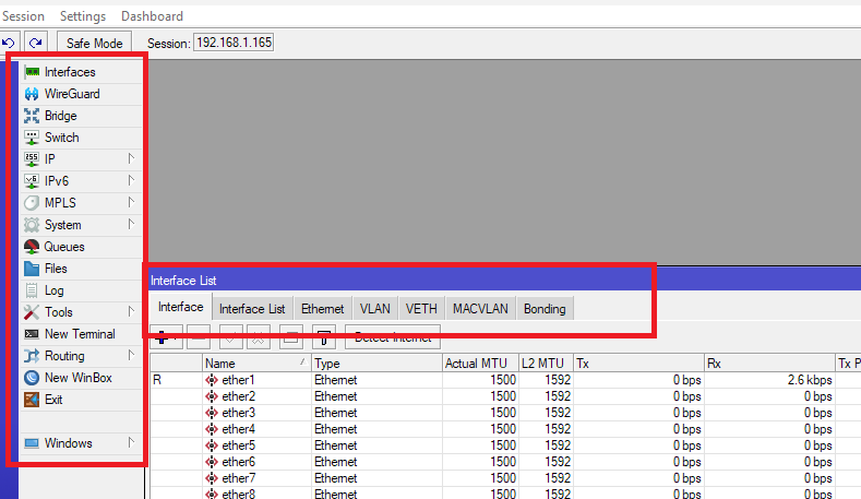

I’m missing a lot of options on Winbox on my CRS326-26G-2S+IN compared to another identical switch, but rack mounted.
Also missing options in for instance the “interface list” option. See attached pictures.
Anyone know why?? Firmware is exactly the same, tried reboot, reset config, etc…
Thanks.
Check the “Design skin” if something got hidden … skins are used both for webfix and winbox …
Yes, thank you.
Had to reset the “design skin”. I got the switch used and stange that this does not go away with a normal reset of the switch…
