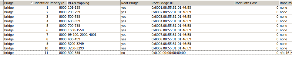

I see missing route bridge id on crs 317 running mstp mtik version 7.10.2. Is there any incompatibility with other brands of switches ?. its connected to huawei. Please find below screenshot.

do you mean the last bridge number 11? with id 0x00?

Rt bridge id on instance 11 which is the instance active here shows 0000. It should show mac of route bridge and also the cost too.

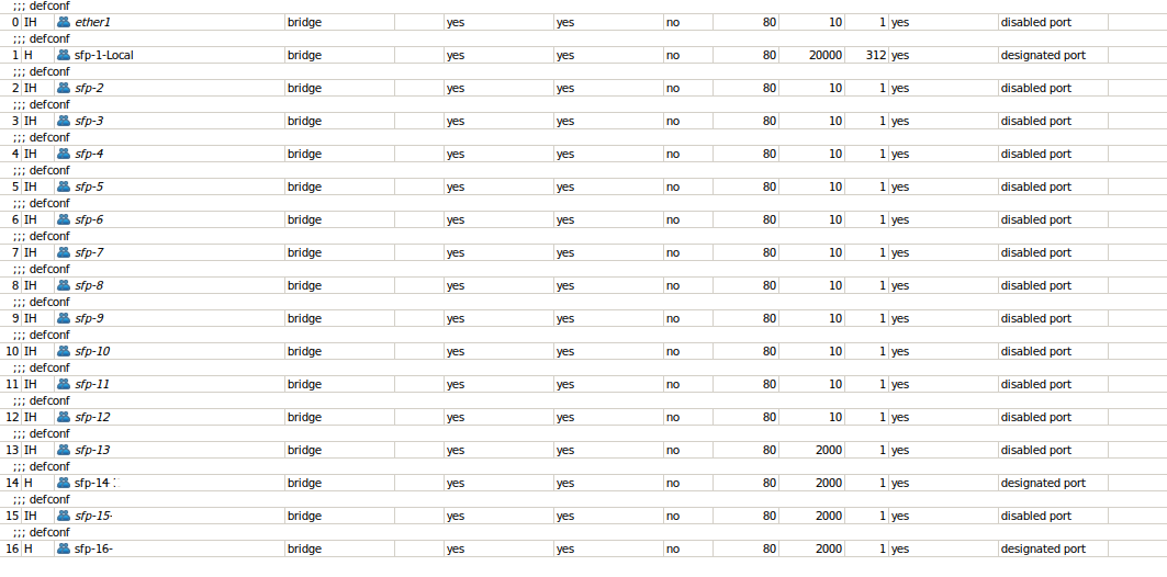

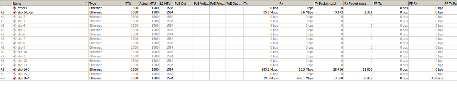

I’m sorry, i thought i have asked you that cli output?
Interface print
interface bridge port print
