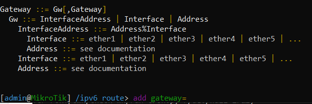

Options 6.x:
bgp-as-path  bgp-atomic-aggregate  bgp-communities  bgp-local-pref  bgp-med  bgp-origin  bgp-prepend  check-gateway  comment  copy-from  disabled  distance  dst-address  gateway  route-tag  scope  target-scope  type
[admin@MikroTik] /ipv6 route> add
Options 7.1rc4:
blackhole  check-gateway  comment  copy-from  disabled  distance  dst-address  gateway  pref-src  routing-table  scope  suppress-hw-offload  target-scope  vrf-interface
[admin@MikroTik] /ipv6/route> add
A function that I used very intensively no longer exists:
/ip(v6) route check
In addition, in many places (or everywhere?) it no longer works by entering a question mark to display the available options. Does it work differently now?
6.x:
7.1rc4:

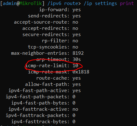

The question “Is blackhole or unreachable better?” cannot be answered clearly for all users. My concern is that the DECISION whether you WANT blackhole or unreachable should be in the hands of the respective network administrator. There are certainly legitimate reasons for both.
I don’t see any reason to delete features that were already implemented in the substructure (Linux kernel / Netfilter / IPRoute2).
There are various ways to protect yourself from abuse.
https://www.kernel.org/doc/Documentation/networking/ip-sysctl.txt
icmp/*:
ratelimit - INTEGER
Limit the maximal rates for sending ICMPv6 messages.
0 to disable any limiting,
otherwise the minimal space between responses in milliseconds.
Default: 1000
https://man7.org/linux/man-pages/man7/icmp.7.html
Linux limits the rate of ICMP error packets to each destination.
ICMP_REDIRECT and ICMP_DEST_UNREACH are also limited by the
destination route of the incoming packets.
