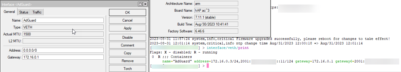

I may be missing something, but whenever I display (or try to change) the IP address associated with a veth (for a container) it shows as 0.0.0.0/0 in WinBox and as a “blank” in WebFig.
Is this a bug or I’m really missing something here?

You can check with “interface/veth/print” in the terminal. If you close the window in the Winbox and don’t click OK or Apply, It should work as expected.
WinBox is 3.39 and WebFig 7.11.1 (latest as of this post).
Yes, it is correct when using the CLI.
Your WinBox image show exactly what I’m talking about: Address: 0.0.0.0/0.
It’s not a question of being able to check the IP address using WinBox/WebFig, but rather to make changes (need apply/ok).
Look what happens when you modify (webFig) a veth interface and “reenter” the IP address:

It ADDs the IP to making it a list… Weird, at best. This is definitely a bug
WinBox at least does not create multiple addresses (edited the last veth to force a change):
[admin@gaia] > /interface/veth/print
Flags: X - disabled; R - running
0 ;;; test
name=“veth1” address=10.10.10.247/32 gateway=10.10.10.1 gateway6=“”
Strangely is that after changing with WinBox, if I open the veth again it shows the IP. But it will revert to 0.0.0.0/0 if I close and reopen WinBox (so it was kept in memory on WinBox).
A clear bug for me.
