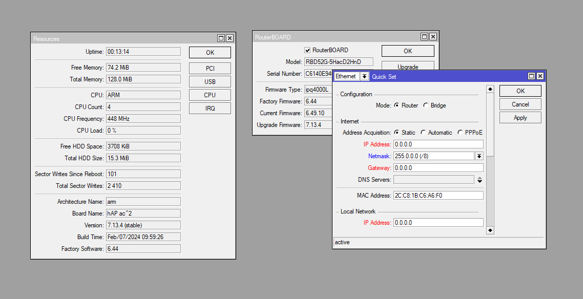

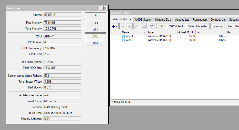

I am the owner of the hap ac2 router. Firmware 7 is installed, the mode is only available in the Internet mode in, dual ap is not available. I installed firmware 6, and dual ap is available. What’s wrong? I think I can try to reinstall it through netistal, but I have no such experience. What is the problem???

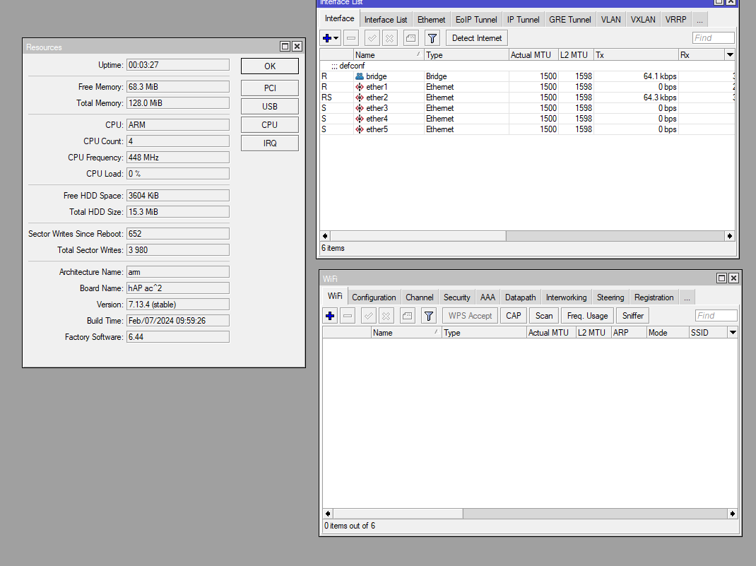

reinstalled from netinstall, the result did not change, for some reason he thinks that he does not have wifi
You must have netinstalled the base OS package only. Add the relevant WiFi packages. Docs may be lagging; all of this changed in v7.13. See that version’s huge release thread for details.
This one might be easier to read, especially the grid.
https://help.mikrotik.com/docs/display/ROS/Wireless
Basically, for 7.13-chain and above:
  • if you want legacy wireless like it was: add wireless package
  • if you want wave2 wifi (ac2 can do it): add wifi-qcom-ac package
For both cases: be aware storage space might become a problem later on.
It might be (depending on how you use that device) best to keep it on 7.12.x for now.
(7.14, currently rc1, does bring some storage gains but not much)
