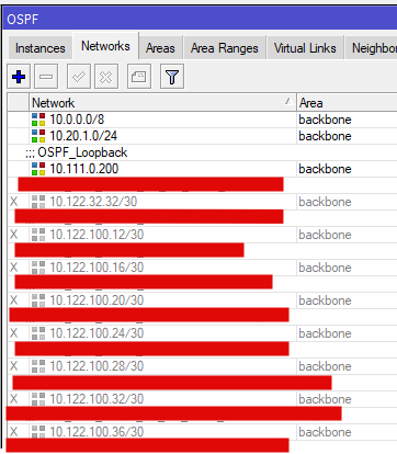

Here is a screenshot and my question is 10.0.0.0/8 necessary when most of the /30 in (10.0.0.0 - 10.255.255.255 ) range are disabled ( used for backup should primary device fail !)
You only need the network statement once, why are you creating multiple /30 network statements in ospf when you already have it declared with the 1 /8?. MAke sure you summarize routes on area border routers, to prevent flapping
I don’t know what you mean they are used for a backup.
The original configuration was done by a techie who is no longer available and I am trying to educate myself why certain configurations exist on this live network,
The /30 are used for OSPF interfaces network-type=point-to-point ?
The OSPF /30 listed are active in another device and should that fail I can enable them until the other device is operational ?
No that’s not how ospf is suppose to works. If your going to go in and enable and disable routes then you need to go back to static routes. Without seeing the big picture that looks to be someone learning how to use ospf. and was making a network statement for every network until they realized they only need to make 1 that summarizes them all.
You are correct that is not how OSPF is supposed to work! But when a Cisco certified network consultant first adds 10.0.0.0/8 in OSPF network and then proceeds to add /30’s within that ip range
with OSPF interfaces network-type=point-to-point, It had me wondering if this was best network configuration practice! maybe this type of configuration works OK on higher-end equipment but not so good on MIkrotik,
Yes I am trying to learn OSPF as the buck stops with me ?
Thankfully only the core routers - 2 X CCR1009’s which share the network load have these OSPF settings!
All other devices have interfaces using /30 like for example PTP ether interface /30, wlan interface /30 OSPF networks, OSPF Interfaces for both ether and wlan as network-type=broadcast
Your putting to much faith in a person.
ospf does not care whether you have 20 /30 routes or 1 /8 (or any other mask that summarizes the other ones) They do the same exact thing. I hate to tell you, but you can be cisco certified and still not know what your doing (especially at the ccna level), and you have not convinced me otherwise.
ospf is a open protocol there’s no such thing as it working different on different routers.
I understand this but while a 1 /8 could be used on the initial network configuration setup but once the 20 /30 etc have been setup then disable or remove the 1 /8 ,
We also have L2 switches used on the network, I wonder how much that adds a complication to the network design ?

OSPF network statement configuration allows for the configuration of different mask lengths so that you can be more or less specific about which interfaces participate in OSPF and start exchanging hellos. It does not have any bearing on the subnet configured for an interface. You can specify a /32 length in OSPF for an interface that is configured as a /27 if you don’t want any other interface within a /24 that covers the /27 to be active in OSPF.
Conversely, you can be more permissive and configure a network statement as a /24 so that any /27 inside that range will automatically start sending hellos and participate in OSPF. It’s worth noting that the “network” style of OSPF config is older and most operating systems have been moving to interface level config for more than 10 years.
