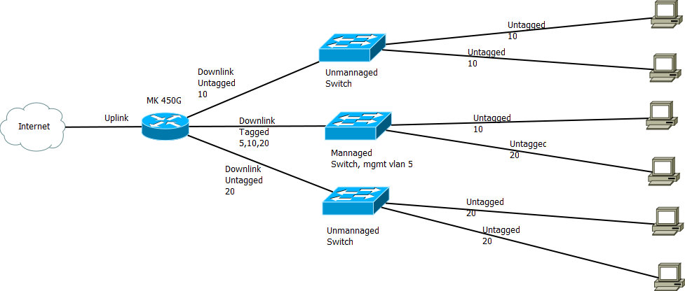

Hi, i have setup vid. attachment and problem is with switch chip in mikrotik. How i can setup untagged port on switch to any vlan? I need to use wirespeed bridging in vlans.
I tried in test router setup one untagged port (eth2) with this rules:
0 switch=switch1 ports=ether2-master-local vlan-header=not-present
copy-to-cpu=no redirect-to-cpu=no mirror=no new-dst-ports=switch1_cpu
new-vlan-id=200
or
copy-to-cpu=no redirect-to-cpu=no mirror=no new-vlan-id=200
or
0 switch=switch1 ports=ether2-master-local vlan-header=not-present copy-to-cpu=no redirect-to-cpu=no mirror=no
new-dst-ports=switch1_cpu,ether2-master-local new-vlan-id=200
All frames arrived on ether2 without tag. Is there any solution?
