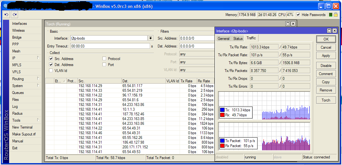

Hello friends, the problem of the torch continues on v5 rc3 x86 … only see the image …

I too am having the same problem, first I get a error “could’t start - interface not up (6)” then when I press start again it shows me a little traffic on rx only just as the image above.
Edit: it only happens on queue’s but when I torch the interface it works fine.
same here …
we are working to resolve problem that if you have queues enabled you do not see tx data in torch. Disabling queues helps, but that is not much of a workaround. So just hang on for the fix.
its bug from RC2, torch get data after queue and dont show traffic.
it will be fixed in rc4 as patch is already done

mk v5 rc4 torch work ok…
