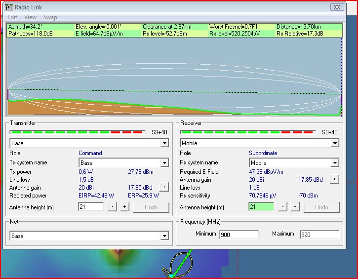

In above, the link with radiomobile. In this link i have some trees in the midle.
