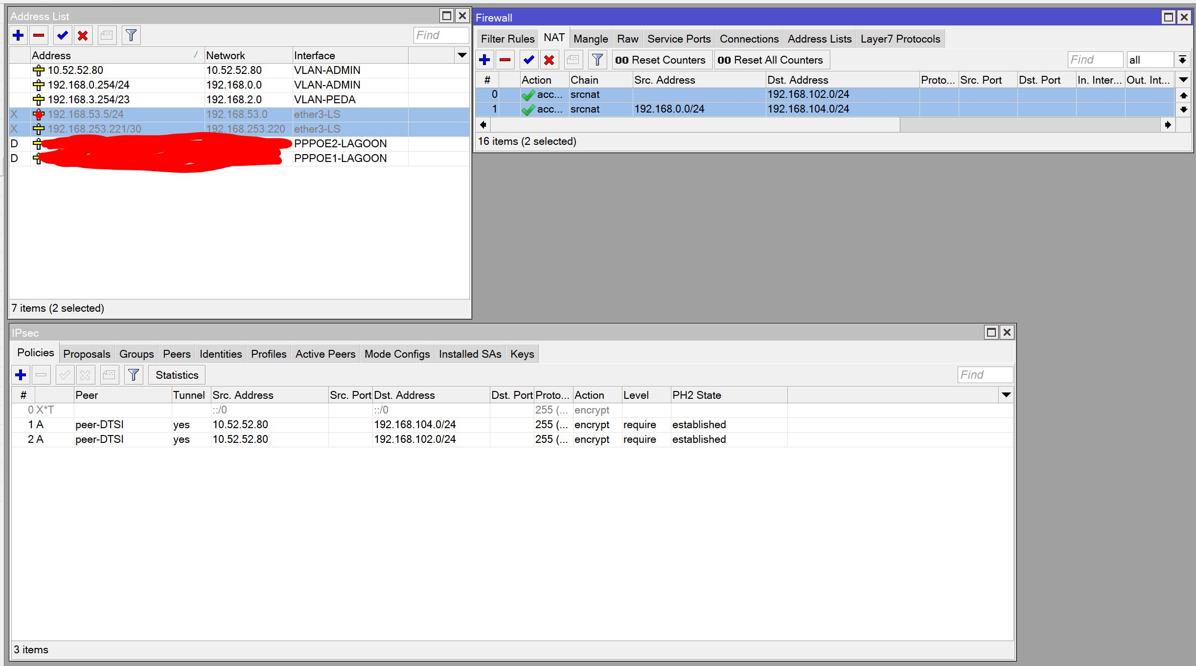

Like this :
add action=src-nat chain=srcnat dst-address=192.168.102.0/24 src-address=192.168.0.0/24 to-addresses=10.52.52.80 ?
Yes, that will allow access from 192.168.0.0/24 to 192.168.102.0/24.

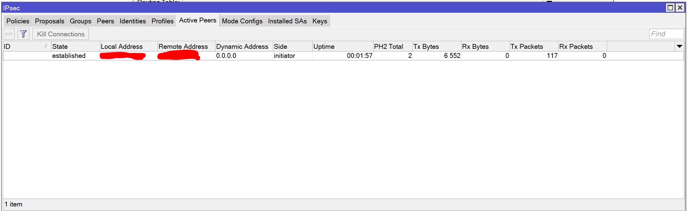

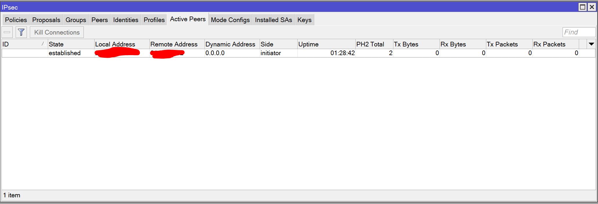

I had already tried this rule.
When I set it up I do not receive any traffic entering the ipsec tunnel.
As I am not controlling the other side of the VPN, I do not know if it is from the mikrotik.
Is there a rule to put in place for the incoming traffic from Ipsec?
It’s hard to say what exactly happens. It can be the other side not sending anything. Or maybe you block it. Normally it wouldn’t happen, but people sometimes invent crazy things. For start, check that you accept all required ipsec traffic from peer (udp 500 and 4500, esp protocol). If you don’t find anything, you can export config and post it it, and if the problem is in there, maybe someone will see it.
