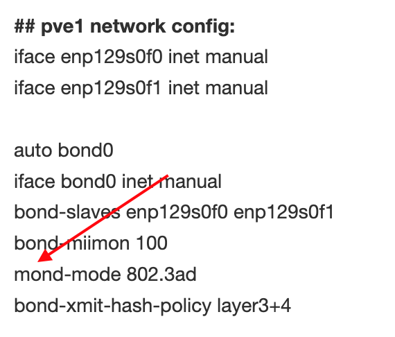

First thing that jumps out to me is this typo:
I know it’s confusing, but it really was a typo when writing here as I was re-typing it from KVM. The host had it right.
