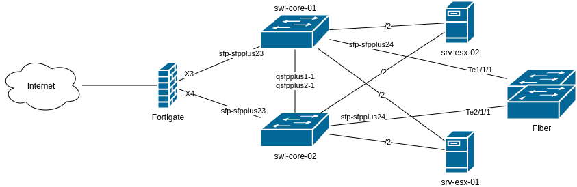

We are trying to implement the following MLAG setup:
The switches swi-core-01 and swi-core-02 are CRS326-24S+2Q+, Fiber are 2 stacke Cisco C9300-48P.

The Fortigate Link is configured as LACP and has VLAN-Interfaces configured on that link. This device does the routing.
We are experiencing issues (STP?) when we connect another Cisco Switch to one of the core switches. To be honest I have no idea if it is a configuration issue or a bug…
