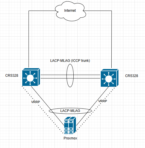

can you give us a simple drawing of your lab? a little bit detail would be better.
I’m just curious about this mt mlag vrrp problem.
Wasn’t sure if you could upload native draw.io files so I’ve just attached a png. Hope this helps?
hmm… I’m wondering whether you have routers in front of those switches facing the internet? or you are literally just using those 2 switches for the internet + vrrp + mlag + server farm?
if yes, then no - your design might not work correctly.
  1. bitter truth is high availability setup is expensive and still has this single point of failure.
  2. vrrp should be on other devices. floating gateway target for those switches, and probably to accommodate intervlan routing as well.
  3. mostly mlag should be on network devices. ie between switches. not directly to servers although they support lacp/mlag. (or even should not directly to edge routers) - which mostly only need lacp.
  4. how those mlag involved devices handle stp is the most crucial thing in high availability setup.
  5. you need to analyze different stp performance. ie between rstp and pvst to know what you are up to.
  6. I’m sorry I can’t read further config - but my guess is that your setup probably has this certain vlans didn’t work - because of the nature r/stp. hence the preemptive session didn’t work as expected.
hope this helps.
Of those points, I only agree with #2. The rest is not true, irrelevant, or just doesn’t make sense in this situation
The whole purpose of MLAG is to help eliminate single points of failure for connected clients, including servers, routers, and other switches. The servers use LACP (LAG) with one connection going to each switch in case either switch fails.
I agree that OP should have a router (or a pair of routers) sitting between the Internet at the CRS328’s, doing the actual routing, and just let the MLAG stack be a switch. Because MLAG relies heavily on Layer 2 technologies to keep track of client traffic, it is likely that the VRRP bits are getting caught in the middle.
Two RB5009’s should do the trick.
true. that’s the idea and the ideal expectation. but unfortunately without proper design - anything with rectangle or triangle or circle involves loop.
sometimes, if we are lucky enough - we get layer 3 loop. do filters - done. worst than that - we rely on stp to solve the problem on layer 2.
lacp pagp mlag mlt smlt dmlt they are all rely on how layer 2 work underneath it. especially vlan trunking if any.
so do you think there will be no link dropped within a triangle? circle rectangle? that is single point of failure.
comparing how much time it will take between vrrp preemptive and stp block learn and forwarding period. we can’t do magic
Confirmed that this is a bug and Mikrotik are going to resolve it in a future release!
