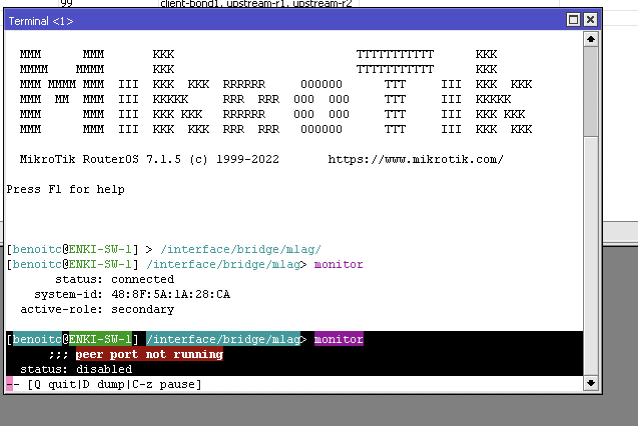

I am testing the MLAG feature and I have an issue when primary switch is down. When I launch a reboot, the MLAG is put on pause on the second switchj annd all slave sconnectiosn stops to work.
For this exampel I have put upstream routers and one freebsd machine in LACP. I have 2 VLAN setup for these machines: 102 & the default 1. These vlans have been tagged for the control port:
What do I miss ?

this seems to be related to freebsd asthe interface is automatically up in the routers. But can someone confirm the behaviour is expected (putting on pause the peer port status) ?
so to summarize:
  • shutdown/rebooting secondary switch is done without any issue, network stays up
  • disconnecting a cable is also working OK
  • removing routers works as expected
  • shutdown primary router introduces a delay before the connection is up again. I don’t why exactly. Maybe a bug in freebsd 13 or a setting to change ?

Hi benoitc,
How long is the introduced delay? Could it take up to 30 seconds?
When both MLAG switches are up, the secondary switch will change the LACP system-id and it will use the same system-id as the primary. This allows connecting regular LACP clients to two different physical switches while the client thinks it is connected to the same switch. You can monitor the “lacp-system-id” using the “/interface/bonding monitor” command and see how it changes after connecting/disconnecting the primary switch.
When the MLAG connection is lost, both switches will start to work independently. For the primary switch, it does not change anything, because the same LACP system-id is used in both scenarios. However, when the secondary switch loses the MLAG connection, it will change the LACP system-id to local values and perhaps this is the reason why connection delay and packet loss might appear?
Do you know if FreeBSD supports a 1-second LACP rate? In RouterOS, you can set it using “lacp-rate=1sec”. Perhaps using a quicker LACP rate will decrease the introduced delay?
Last, you are using the pvid=99 on peer-port, while using the same VLAN in “/interface bridge vlan” menu. Try setting the peer-port to some unused untagged VLAN, e.g. pvid=999.

That may be around 30s yes; I will recheck. I noticed also there are some delay on the server due to bird esetting the routes on changes. I need to retest. For the rate, I did’t found yet an option for it but stillooking. I will report soon .
As for the vlan it’s only usedd for ctl. I have misread the doc and tagged the other devices for it. This is fixed now :slight_smile: Thanks for the hilight :slight_smile:
yes it has filtering enabled. . I will do a new test session later today , I will report it son :slight_smile:
