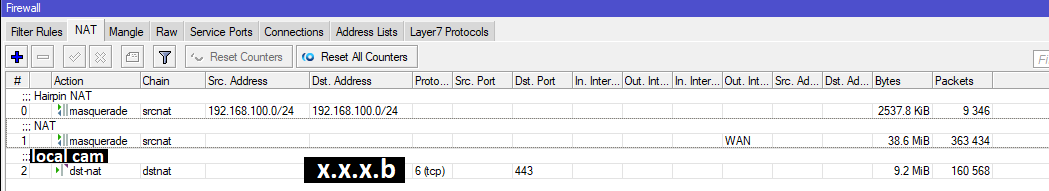

Here’s my current NAT config:

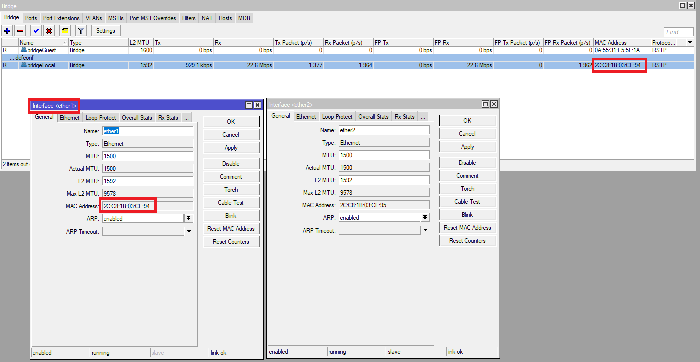

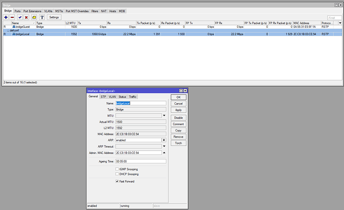

On bridgeLocal the admin MAC still the same of ether1 MAC?
Change that MAC with eterh2 MAC
I'm not sure I understand what you're saying.. "bridgeLocal" - "Admin. MAC Address should be changed? what effect would that have?
Is the same MAC of ether1 or the sfp?
Must be the MAC of ether2
The MAC address matches.. WAN (connection to the ISP modem) of the MikroTik router is ether1, as it should be.

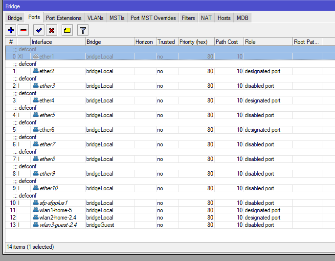

You have removed (disabled) the ether1 from bridgeLocal,
but you do not have changed the admin MAC with one of ethernet presents (still active) on the bridge (ether2).
No need to get upset, I'm reading what you wrote, the problem is, it was not understandable. Okay, I see that the "ether1" is disabled in the localBridge, but I didn't do that manually, it must've happened during the initial configuration.
Should I keep it disabled? or enable it? And, if I keep it disabled, you're saying I should adjust the MAC of the "localBridge" with the MAC of "ether2". Again, what kind of effect will this have?

You can not reach the configuration pages with 109.?0.15?.2?9 instead?
Probably the router webpage is contacted from 109.?0.15?.230 because you nat the 192.168.100.0/24 on WAN exit
and your must omit the NATting for 192.168.178.0/24 because for security probably, can reply on ping,
but web access is restricted for same range of addresses 192.168.178.0/24

I never wrote to enable ether1 inside the bridge (at most delete it)

add NOT ! dst-address 192.168.178.0/24 on your SECOND NAT rule
