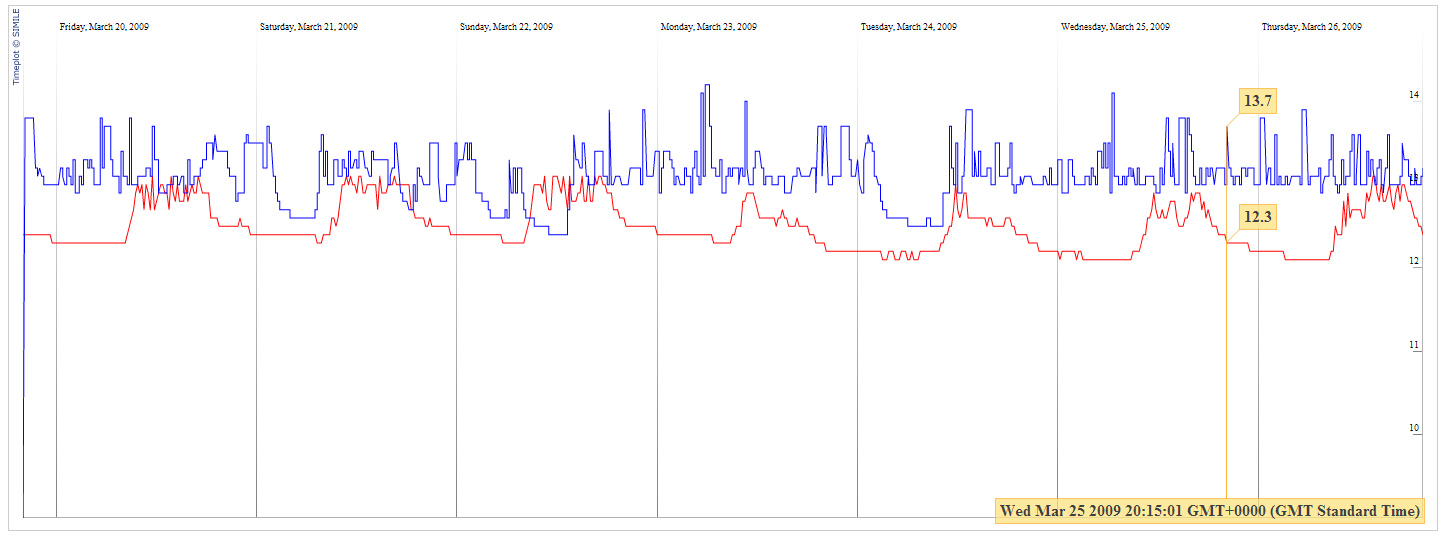

Here is a sample of what we have running from out Mikrotiks.. all this data is automatically (every 15 minutes) accumulated and graphed for our convenience :slight_smile:

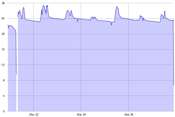

Can you give a screenshot of what your voltage monitoring looks like in the Dude just as an example?
here we go
Thanks for the demo.
