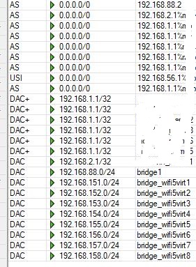

In Dude, I was able to find the oid for some routes, at first glance for dynamic ones.
but there is also a default static route there, the top one, has oid 1.3.6.1.2.1.4.24.4.1.16.0.0.0.0.0.0.0.0.0.192.168.88.2

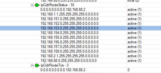

Specifically, for the route highlighted in the screenshot, the oid is: 1.3.6.1.2.1.4.24.4.1.16.192.168.153.0.255.255.255.0.0.0.0.0.0
