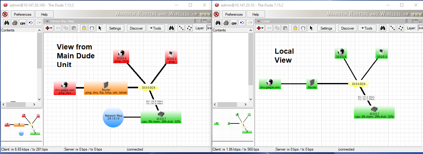

This picture shows my connection from the Main Dude server VS a direct connection to the node on the remote site.
This is what the remote service shows on the main Dude server.

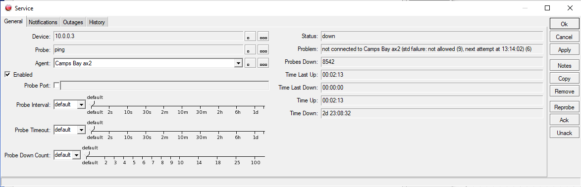

When we add an agent we also can set its credentials. Are these credentials have all required permissions?
On your second screen there is an error
not connected to Camps Bay ax2 (std failure: not allowed (9), next attempt at 13:14:02) (6)

That policy was removed in ROS 7.6 .
You don’t need it, just try to set full admin credentials and check the result.
