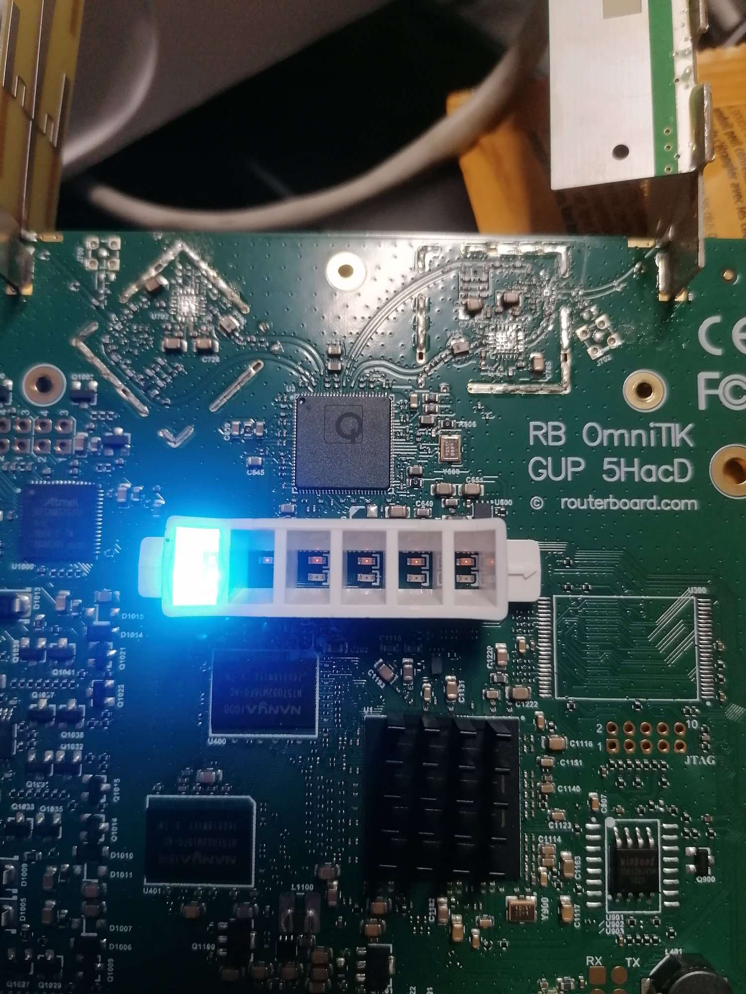

Omnitik : 3 devices where the RF power amplifier gave short-circuit on the 5V of 3V3 lines (no lights on the device, PCB getting hot and making a buzzing sound)
on these last devices i removed 1 or 2 RF amplifiers, see picture
