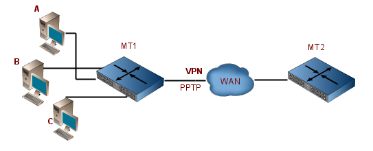

ahmedsaffar thanks for your quick reply!
Let’s see, you’re right, there are two RB153 involved in this.
See the picture attach.
Only A is allowed to connect from A;B and C.
But if some one else want to connect from a different location to MT2, could do it without problems.
Question: what should I do to allow more than 1 PC from the same IP address to connect via VPN (pptp) to MT2 ?
thanks in advance to ahmed or anyone in the forum !
Hi again ;
Well be logic your MT2 is like a web site on the internet .
as we said before that in your MT1 there will be two interfaces :
ether1 → to the wan .
ether2 → to the local network .
and also we said that you are going to add a pptp client server to ether1 and provide it with the information required to establish this VPN .
you should add a NAT rule in your firewall with masquerade action to make all the connections from pc’s behind MT1 to MT2 looks like as it from a one client .
also you should check in the pptp server inside MT2 , if there is a limitation as one session per host .
i am not fully experinced with pptp , but trying to help you .
also i will do some tests on this .
with best regards .
