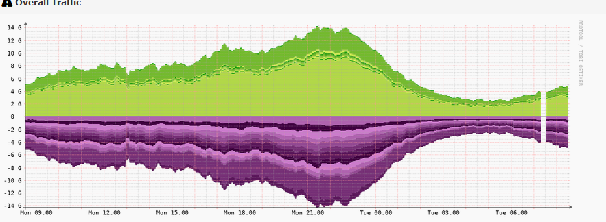

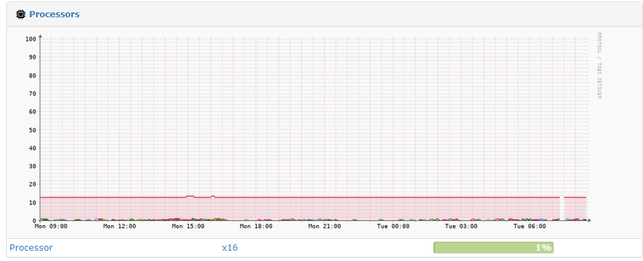

CCR2216-1G-12XS-2XQ
uplink 40g
CPU 1%
stable working 1 months
7k arp
16k route
l3hw enable
working all exept bgp confederation
